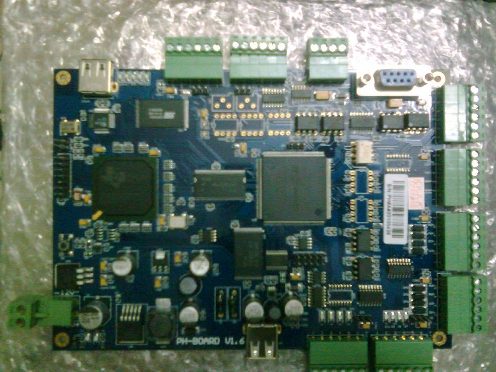

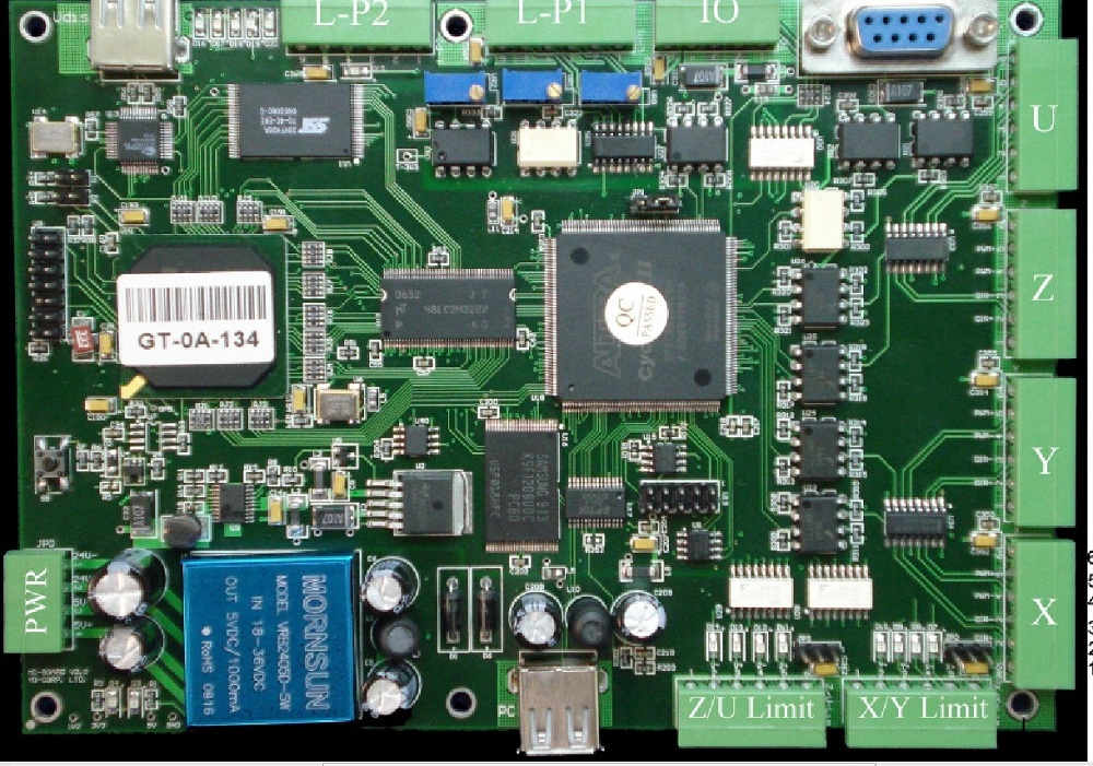

Today I got my controller board in India - thru a friend in the US, upon comparing with images I noticed that the board I have received missed a few IC's, my version of the board (as printed ) is 1.6,
the missing ic's are 25, 26, 15, 31, 32, 29 snf vr0, vr1
is this normal??? also can I use rotary with this board with the ic's not present ????
also on the power terminal 12V+ and 12v- is mentioned - is the the 9v to 24 v dc connection I can give to the board??
Regards
Irfan
original (think V1) board
Board I have received

irfanulla wrote: ... on the power terminal 12V+ and 12v- is mentioned - is the the 9v to 24 v dc connection I can give to the board??
Irfan,
The current version no longer needs the 12v. Just give 24v to the power in and you will be fine.
I suspect the "missing" chips are in part related to the power requirements and to general simplification and refinement of the product.

Finally I think the missing parts relate to
1. disabled Z limit switch
2. Disabled U and Z axis??
3. disabled L2???
this is from reading other threads
I hope the firmware is full version - that it works if I install the additional IC's

irfanulla wrote:Finally I think the missing parts relate to
3. disabled L2???
Can I not expect some decent answer.
please
Hi irfanulla!
Marco is still in China with very limited access to the web/email. If you are using ver 1.2 of the blue board, then I believe your assessment of the missing chips is correct. I think all can be corrected with the addition of the chips discussed elsewhere in the forum. If you are not sure what to add and where, I have copies of the documents that we posted. Let me know.
I suspect Marco will be back in the next week or so.
