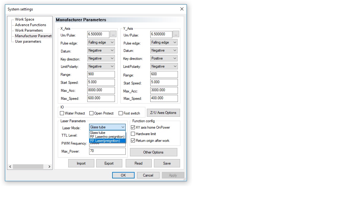

What is the key sequence to get into Pre-ignition settings on the LO-E5?
Lasercad does not access this.
I was told by Sam last night that this was possible.
How do I turn on "Pre-ignition" for RF?

Re: How do I turn on "Pre-ignition" for RF?
See image
You can't change the % or time because it should be handled by your RF tube/ circuitry internally
For RF, I was told that the frequency should be set to '5000Hz'
