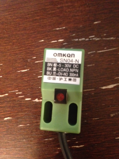

Here is the sensor I have

I guess that this limitswitch (proximitysensor) has three wires, and probably brown, blue and black, right?
Blue is your GND-wire, Brown must be connected to the +24V and Black is the output, which should be connected to the limitswitch input of the controller.
Think of a corner where you want your homepoint to be. for instance right-top.
Place the head somewhere in the middle and see it it moves to the right corner when you turn on the machine. If not, you have to change settings..
You only need two sensors normaly, both in the corner wher your homepoint is. And maybe another for auto-focus..
