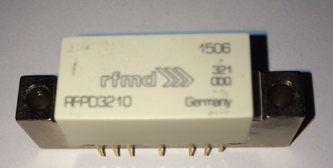

Looking for advice/comments on suitability of an economical DIY machine for engraving fine text on plastic (PTB Polyester), example in below image file. I am not experienced in tradeoffs for laser engraving but am technically able to fabricate and assemble a DIY cnc machine.
The engraving area in image is approx 1.1in x 0.6in and I will be arraying parts in batches of 100ish pieces.

A regular CO2 laser won't be able to handle this kind of engraving. You need a label 'marking' machine instead. It is similar to a fiber optics laser machine but with different light spectrum. It won't be cheap through. Be expecting price range at $6500~$9,000.
