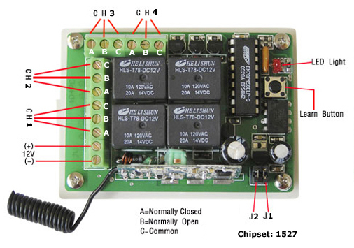

This is the manual for the latest 4CH RF controller. This controller is employing IC 1527 that make it so unique. It now supports two modes for the 4CH model. CH1 & CH2 Toggle and CH3 & CH4 Momentary (only J1 and J2 short)
Plus, CH1~CH4 can works indpendently in Toggle mode with J1 Open and J2 Short.
