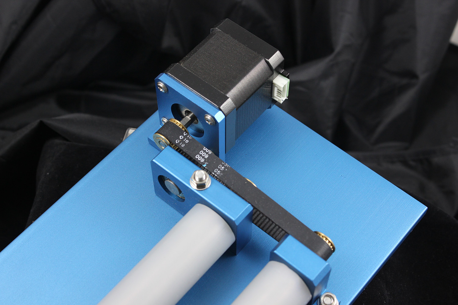

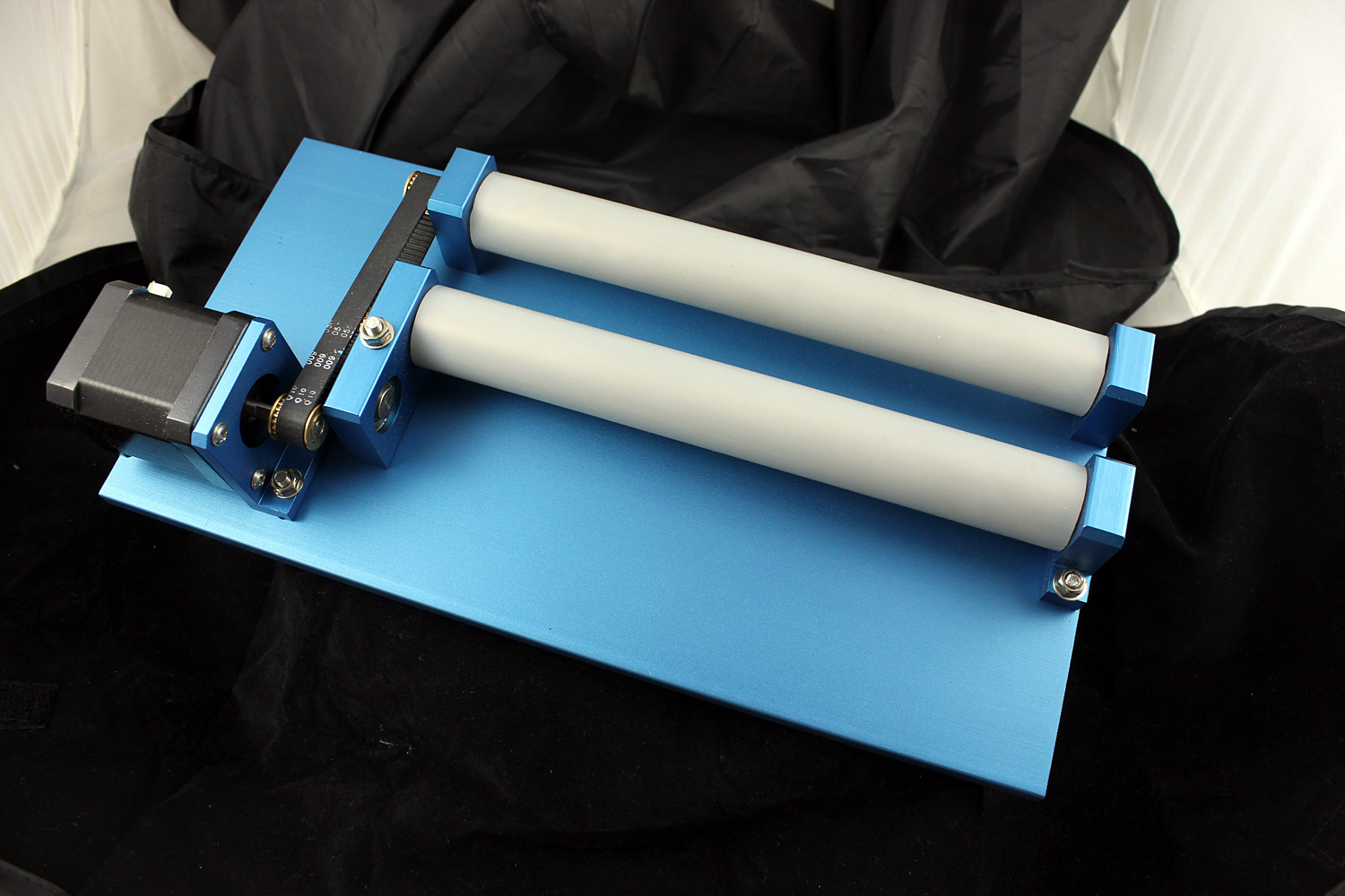

Redesigned a mini rotory for the mini K40 machine. Similar mechanism but with better materials and enhancement.
Instead of using aluminum, the two rolling rods are made of steel and has a silicon jacket wrapped. So that it will not cause any scratch on dedicated object like anodized aluminum, glass, or object with coating. The base board and other parts are made of aluminum. Motor is a higher torque EMOT-42HS03.

It is much prettier than mine! (I bought an early design (prototype?) 'cos I was desperate)
But now that I've tamed it I'm deep into engraving 'Somerset Cider Brandy' onto the second hundred brandy glasses with my old rotary, it's running beautifully.
Because the old design didn't have coated rollers I 'painted' three or four layers of latex onto the rotating rollers just at the point where the glass bowl touches and this prevents both scratching and slipping. This shouldn't be necessary with the new coated rollers.
Nick
Nick

r3ll1k
Re: K40 mini rotary. Higher quality made
I can't find the wiring diagram for this motor, please advise.
EDIT: Do not purchase this mini rotary, the motor is wired incorrectly. Please refer to the Nema HS datasheet!
Techgraphix
- Posts: 492
I can't see it very clear but it looks to have a 6-pole connector(?)
In that case it can be a unipolar motor.
But this type of motor can be connected as a bipolar type:
First find out which connectorpoints belong together. There are two sets of coils in it (A and B).
With a multimeter in Ohms you can measure a small resistance between the connectorpoints. The Connectorpoints that do conduct are from one coil.
In case of a unipolair motor you will measure a resistance between 3 points: two equal and one double. example:
between point 1 and 2 you measure 2.4Ohms, between 2 and 3 you measure 2.4Ohms and between 1 and 3 you measure 4.8Ohms.
In that case point 2 is the centretap of that coil. Leave that unconnected and connect point 1 to A+ of your drive and point 3 to A- of your drive.
Do the same for the other 3 pins but then connect it to the B+ an B- of your drive.
If the motor turns in the opposite direction, just swap the A+ and A- wire on your drive and the motor will turn in the right direction.
Select a current so that your motor will not turn too hot after half an hour.. Handwarm is fine. If it stays cold, you may increase the currentsetting for more torque. start with a relative low current, not to low else it will stall..
BTW the rotary looks very neat but i have my doubts for objects that are round but not cylindrical (like wineglasses, conical forms, flashlights, some bottles etc)
r3ll1k wrote:I can't find the wiring diagram for this motor, please advise.
There is no absolute rule for wire arrangement for the motor. NEMA stand for the unique size of the motor. You are requesting return for returning the product so RMA# will be issued today. But I don't think that it is appropriate that to tell not to buy on your post while most buyers able to make it works As I mentioned that many parRd here we are selling are DIY and no formal document. You ask if you have any question but instead you negative review the product. You didn't find solution here didn't mean that no support because many folks asked questions throes emails.
