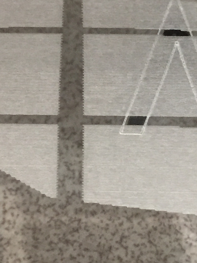

I was wondering if anybody has seen this effect when engraving ?
When engraving X-horizontal by-directional I get what appears to be delays in marking. This also occurs in the Y-directional as well. The engraving parameters are as follows :
300mm/s
10% power
X-axis by-directional
scan gap 0.15mm
The result is a staggered marking. (see picture)
Thank you in advance for your support.
Engrave results (acrylic)
Re: Engrave with AWC608 controller question ?
Try change the "Pulse Edge" under the manufacturer parameter see if it help
Do the X first, then do the Y later, one by one.
