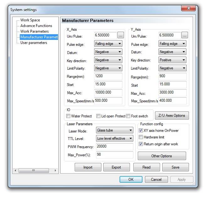

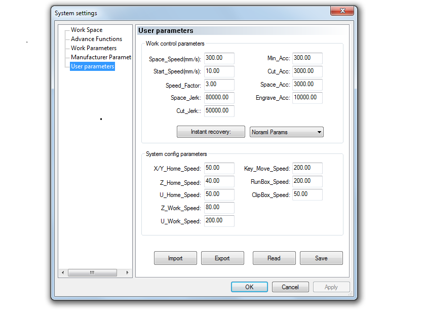

At the request of speedythinker I am attaching a screen shot of both Manufacturers Partameters and User Parameters.
