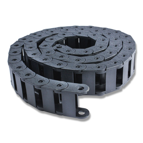

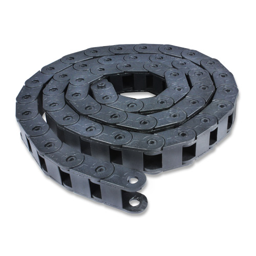

Re: New product suggestion
See the cable carrier

Tech_Marco wrote:See the cable carrier
I'm getting another order ready. Please e-mail info on 20mm carrier part number and price.
Hey Andy:
Here is the link for two different size cable carrier:
http://www.lightobject.com/Search.aspx? ... %20carrier
Picture didn't show the two end connectors but it is included
