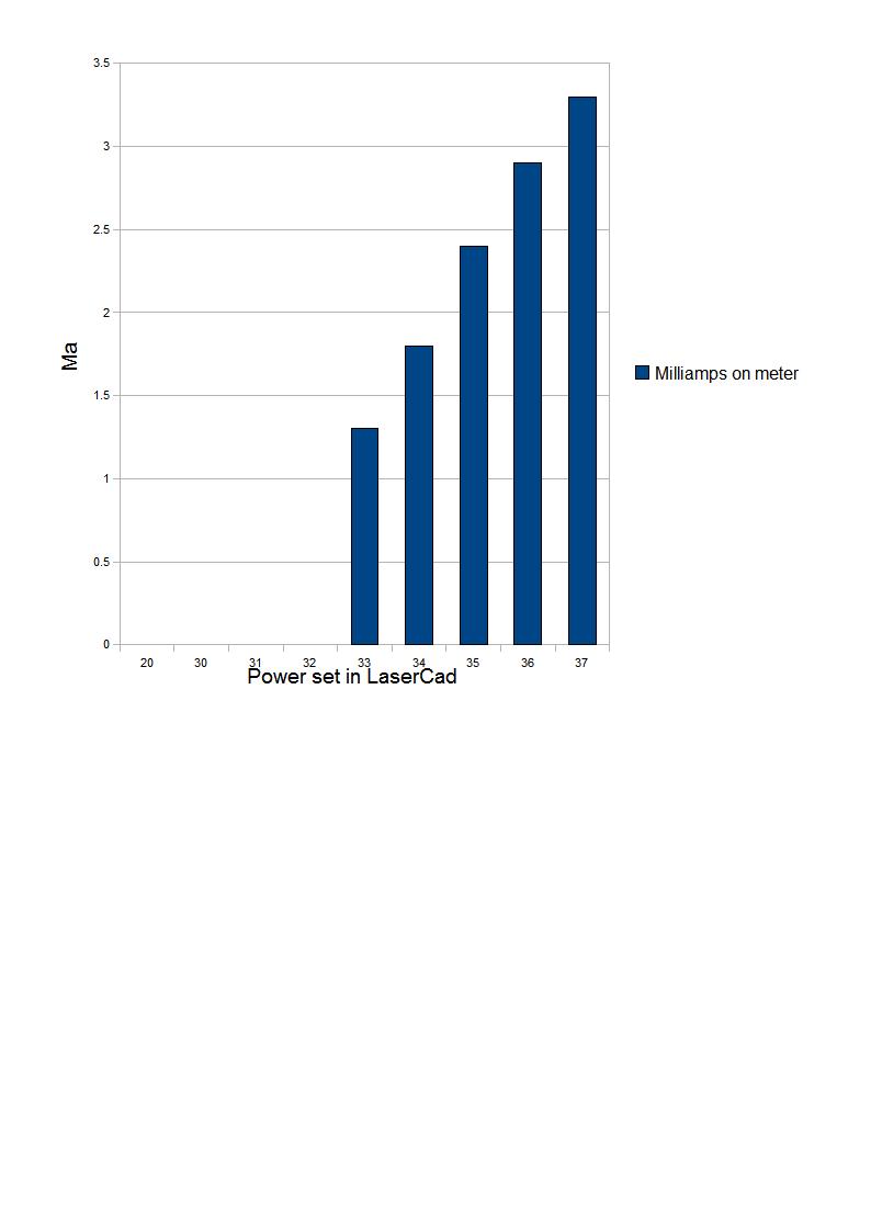

- Posts: 23
Re: Why can't I set my power level to less than 35%?
Thanks for getting back to me Marco.
I just ran some tests using Lasercad. I drew a rectangle and set the line to cut.
Here are the results:
Power-------------Milliamps on meter
20-----------------0
30-----------------0
31-----------------0
32-----------------0
33-----------------1.3
34-----------------1.8
35-----------------2.4
36-----------------2.9
37-----------------3.3
I even graphed the results. It looks nice and linear from 33% onwards but below that it just falls off the cliff. Most strange!!!

- Posts: 4654
Then what is current when 100% is set?
Usually it is the power input issue on the PSU
But if you can get as low as 0mA and full output at 100%, I don't see a big deal. Just get used to it.
- Posts: 23
I'll check the power output at 100% however I really to want to get the laser tube to fire at low settings. There is no in between with the way the system is now. I either get 0 power (no heat) or 1.3ma. Sometimes I need to cut paper or mark really thin veneer without burning right through. A setting of 33% and 1.3ma is too high for this. Should I be able to get the tube to run at 0.5ma? I should mention that my laser PSU seems to be an 80W unit and my tube is only 40W. Could this be a problem?

- Posts: 4654
You shouldn't use a 80W PSU for a 40W tube! The tube could be damaged and you won't be able to fine tune output current. I don't understand then why you said that it was original tube and original PSU. If that's the original machine you have, then the manufacturer is shame of being ignorance.
If 1.3mA is too much for paper cutting, the your only chooice is to increase speed to offset the higer current output
- Posts: 23
I am using the original tube and the original PSU. The fact that they are mismatched is an example of how badly put together this machine was. The manufacturer should indeed hang their head in shame! I checked the power at 80% and it was showing 26.4 ma. I only did a very short run as I understood that a 40W tube should not run at more than 18 ma.
I think I will do as you suggested and increase the speed. When the tube dies I may extend the chassis and fit a 60W tube and maybe a new PSU.

- Posts: 4654
You may enable the "PPI" that is designed to control output by sending pulse beam and the rate is fully adjustable. Since you're having a 80W PSU, it is not very stable when firing at low current say 2~3 mA. I believe that for a 80W tube an initiated current that runs at stable output should be set to 4mA or above.
Anyway, you should not set current too low as that will cause unstable output and it would be pretty bad for especially on engraving. I can't tell you exact amount of current needed because each tube, even though with same power rating, has it's own characteristic. I will take advantage of having higher speed cutting/engraving or using the PPI feature.
