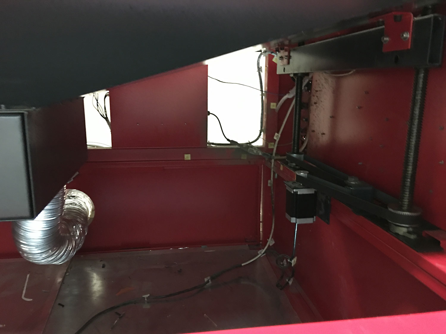

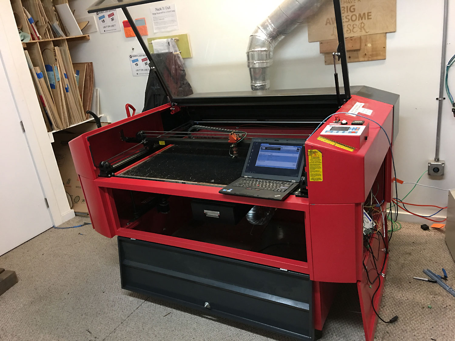

The machine was kind of old, around 7 yrs per Rachel. By looking at the machine in and out, it was in pretty bad shape. Belt was lose, 2:1 wheel was noisy, Emergency button was gone, cover harness was not connected... The system was running at AC220V with their own circuitry for charging system (they charge by hrs used). After power it up and test the laser. No good! I saw sparking happened inside of the laser power supply, the brass casing type.
After a brief discussion with Rachel, we have to replace the controller card no matter what would be next. Plus, the laser power supply need to be replaced even though I told her that she may recovered it or repaired by 'tech_marco'. But she decided to neutralize. Ok, let's start the show!

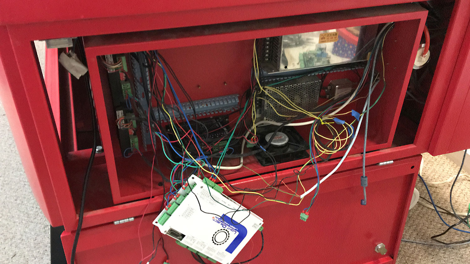

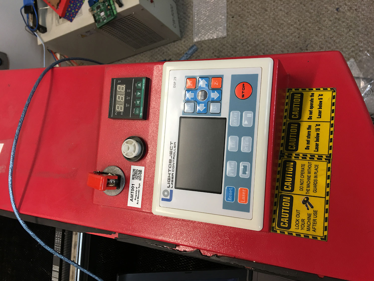

Before removing parts away, I used my phone to take a couple shoots of the current wiring setup just in case I need to put back the old fellow to machine even though the odd was extremely low. It took me roughly 2hrs to take old card out and replaced it with LightObject T9 DSP controller (Ads time smile ). What an excited moment when ready to power it up with new controller!
Ops! When powered up the machine, I could see lights ON on the motor driver but no movement on the gantry. The LCD screen show nothing but I could hear a beep sounds from the controller which was a usual. My first thought was that the power for the controller may be lose or discounted. I tested it with my DVM and found nothing wrong. I unplugged the terminals on the card and put it back, the machine started running but in wrong direction. No problem I could get it fixed by going to the manufacturer system setup and reversed the Datum direction. After that, I recycled the machine and thought that the problem should be addressed well. Well, surprised me that it didn't run as it should and it happened exactly as the first power up. I started to scratch my head and wondering why. I unplugged the power and plugged it back again, it started to run again! Then, I noticed that there was a green LED blinking on a DC 24V power supply. The first thing came to my head was that the DC power supply may not output enough current. Ok, then I swapped it with my Dual36V/24V dc power supply which was good for both motors and control power. After I swapped the DC power supply, it runs as it should. But...then....

Now the machine was able to move and with correct homing location. Except that the button Left and Right were reversed in respond to my press. No problem, it was nothing but easy fix. Again, use manufacturer setup and I could fix this little issue quick and easy. Ok, the machine works in both direction(homing) and button direction. Next, laser power supply replacement!
