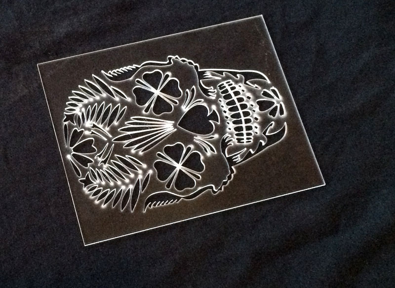

I bought my K40 2 weeks ago and I understood that with air assist you can cut 3mm acrylic. I can only get my laser to cut halfway through. Has anyone cut 3mm with Moshidraw on the K40?
Another question - If I were to upgrade to DSP could I cut small and intricate things like this?

With DSP you can do everything you can do on Moshi but more. BTW, the picture you attached is not a vector format graphic but raster (.jpg). So, it is good for engraving but not cutting. Vector image can be created from one of this (but not limited to) software: CorelDraw, AutoCad or Illustrator.

the DSP is quite capable, but it really is a matter of garbage in/garbage out.
i would expect no problems cutting a piece like that if your artwork is good.
