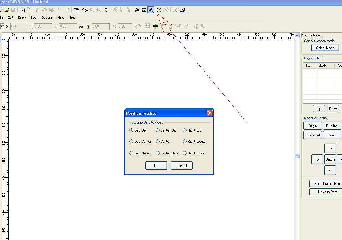

Re: Engrave beyond size
You need to check the setting of "Relative position". If you don't do it setup properly, you will always get "Beyond size.." error
Make sure the Relative Position match the Home Switch as many folks always having this trouble. It's not just the acceration or speed issue. It is this: relative position
Thanks marcoTech_Marco wrote:You need to check the setting of "Relative position". If you don't do it setup properly, you will always get "Beyond size.." error
Your service is second to none.
I am a little confused as to what you mean.
Do you mean if my home switches are top left the the relative position on the toolbar (two little boxes with an arrow) should be selected as top left?
If this is what you mean that is the setting I have.

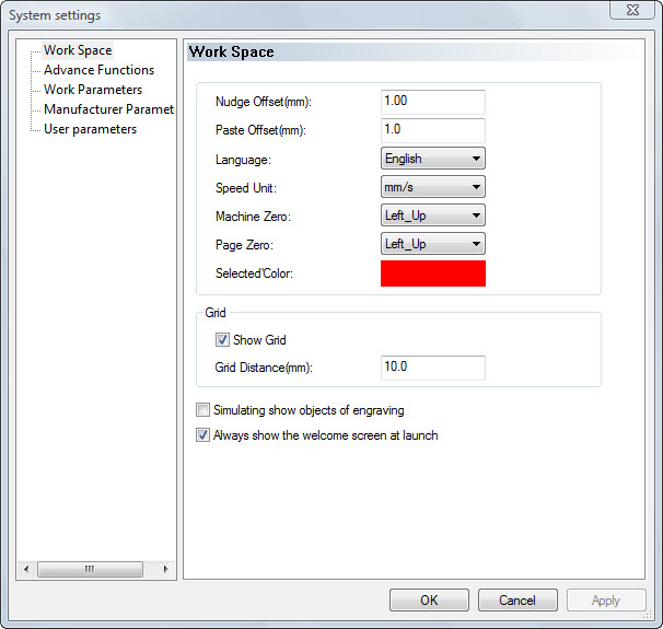

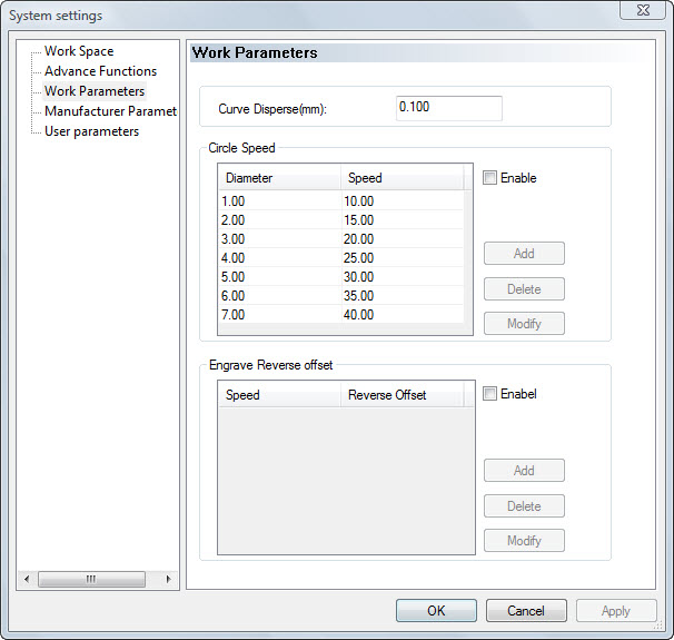

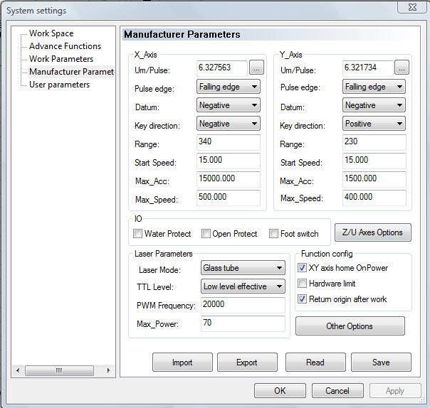

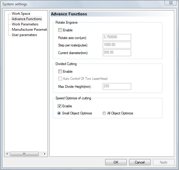

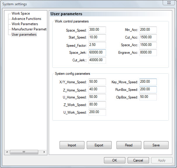

here are some screen captures of the settings maybe these can help someone help me.
As I say It cuts just fine ......
John
I didn't see your setting on "Position Relative"
If your limit switches (Home) are installed at Top-Left, then you better set the positive relative to "Top-left" also called "Left-Top"
Important note: Once you have changed the mode, you need to hit "Reset" button on the LCD unit to refresh the change. Otherwise, it won't take any effect for the new change you made!
Hi MarcoTech_Marco wrote:I didn't see your setting on "Position Relative"
Thank you so much for your time and patience
As I said earlier yes they are set "top left" on switches and top left in relative positions.
Well its late now so it will all wait until tomorrow.
Maybe I will be clearer headed and can work through everything one by one
Goodnight and thank you again
John
I'm curious how big of your file if the problem still exist after all this setting.
Also, what is your Orign mode set to? Software, machine, or Key control?
You may want to try a small image, say 100mmx100mm before doing bigger image. Then, place it in the middle of the engraving area. Make sure you use "Key control" for the Origin mode and moved the laser head to the center and try engrave it.
If your image is in over-size say, 300x200 this big, that could be an issue if you didn't align it well. You need to make sure you have enough 'margin' on each edge for the laser head to speed up. Accelearton set X to 10,000 and Y to 5000
Hi MarcoTech_Marco wrote:I'm curious how big of your file if the problem still exist after all this setting.
I couldn't go to sleep LOL...Had to crack this....AND with success !!!!!
This error was occurring when it was just 1 letter so not a file or image size problem.
The actual item I was trying was 52mm x 85mm.
I looked at all the things that could be seen as a size thing...one by one..
It turned out to be the "origin" point I had to set it in 3mm on both the X & Y.(using the keypad!)
What was throwing me is I was moving the image over from the start point to give it the acceleration space but simply doing that did not change anything.
