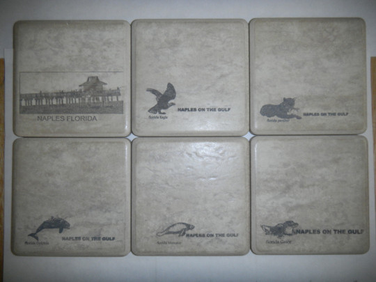

Thanks for the photos! It's good to see that you can use one of these small machine for serious work.
