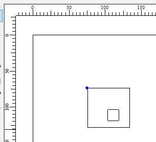

Hopefully this will illustrate: When I create a new figure and put in my box, here is what I see in LaserCAD:
- 10mm square at (100,100)
- WeirdOrigin.PNG (2.52 KiB) Viewed 4710 times
The blue diamond seems to be the figure's origin. I will call this the "origin dot."

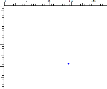

If I add another figure, the "origin dot" moves along with it.
- new rectangle, new origin dot
- WeirdOrigin2.PNG (2.98 KiB) Viewed 4710 times
What I want is for the origin dot to be at (0,0).
