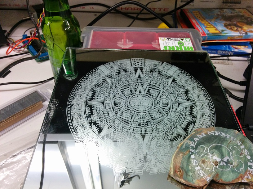

This is what the laser is currently producing. Seems like its working well, but Im building this to give to a friend so I want to make sure its right.
