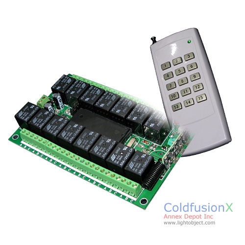

15 channel RF controller Programming Instruction
Programming step:
Press learn button and a LED will lit. Press a button on the remote for mode selecting.
Modes:
a) Momentary: S1 open, S2 open
b) Toggle: S1 shorted, S2 open
c) Latched: S1 Open, S2 shorted
D) Disable: S1 shorted, S2 shorted
Specification:
- Operating voltage: DC12V
- Channel: 15
- Idle current: 7~8mA
- Frequency: 433MHz
- Sensitivity: -103dBm
- Size: 115mm x 73mm x 16mm
