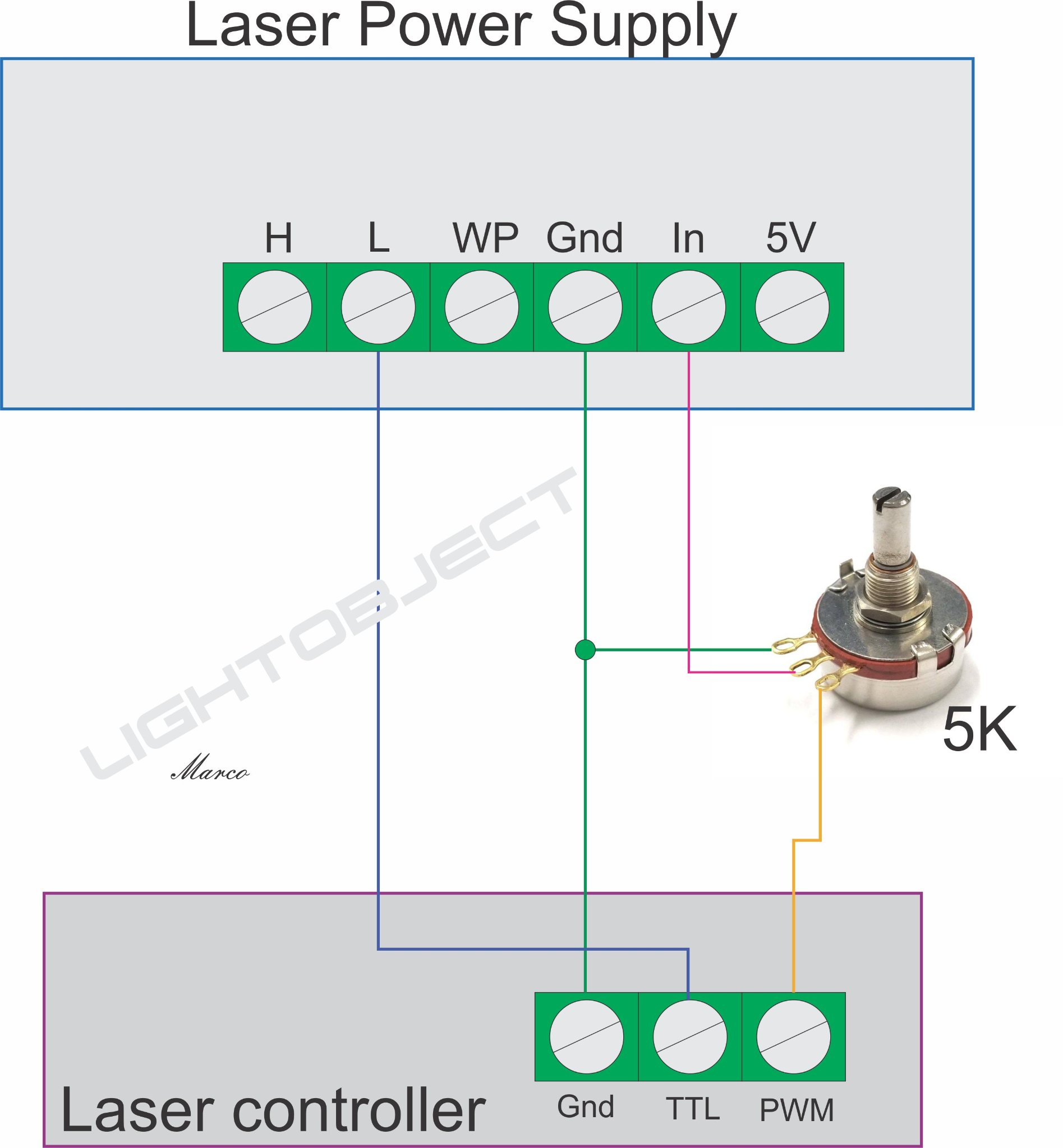

Re: Adjusting power supply for max power?
Let me draw you a simple diagram and will post it once done
See this:
Post by DanoInTx »
This is perfect Marco, pretty much how I pictured it except I didn’t have the 3rd leg to ground. I’ll give it a shot and report here if it works out.

I finally got around to trying this, but it doesn't seem to work. I don't know that limiting voltage from a PWM output works this way, PWM is the width of 5v pulses, not the actual voltage, so I either get nothing or full power. Pretty sure I have it wired as per diagram above, but I think somewhere in there the PWM needs to be converted to voltage 0-5V from PWM (5 volts with variable width), with this I think I'm just limiting the height of the pulse. My background is not electronics, so I could be wrong here? Thank you.

Found that my controller actually has an analog output as well as PWM. Some images of the Ruida RDC 6442G-B (EC) show a 24V in this location, while others show L-AN1 on the same spot on the controller (different pictures even in same manual, gotta love it). I also found I had a bad potentiometer which wasn't helping me figure this out. New pot, connected to L-AN1 and I'm in business!
