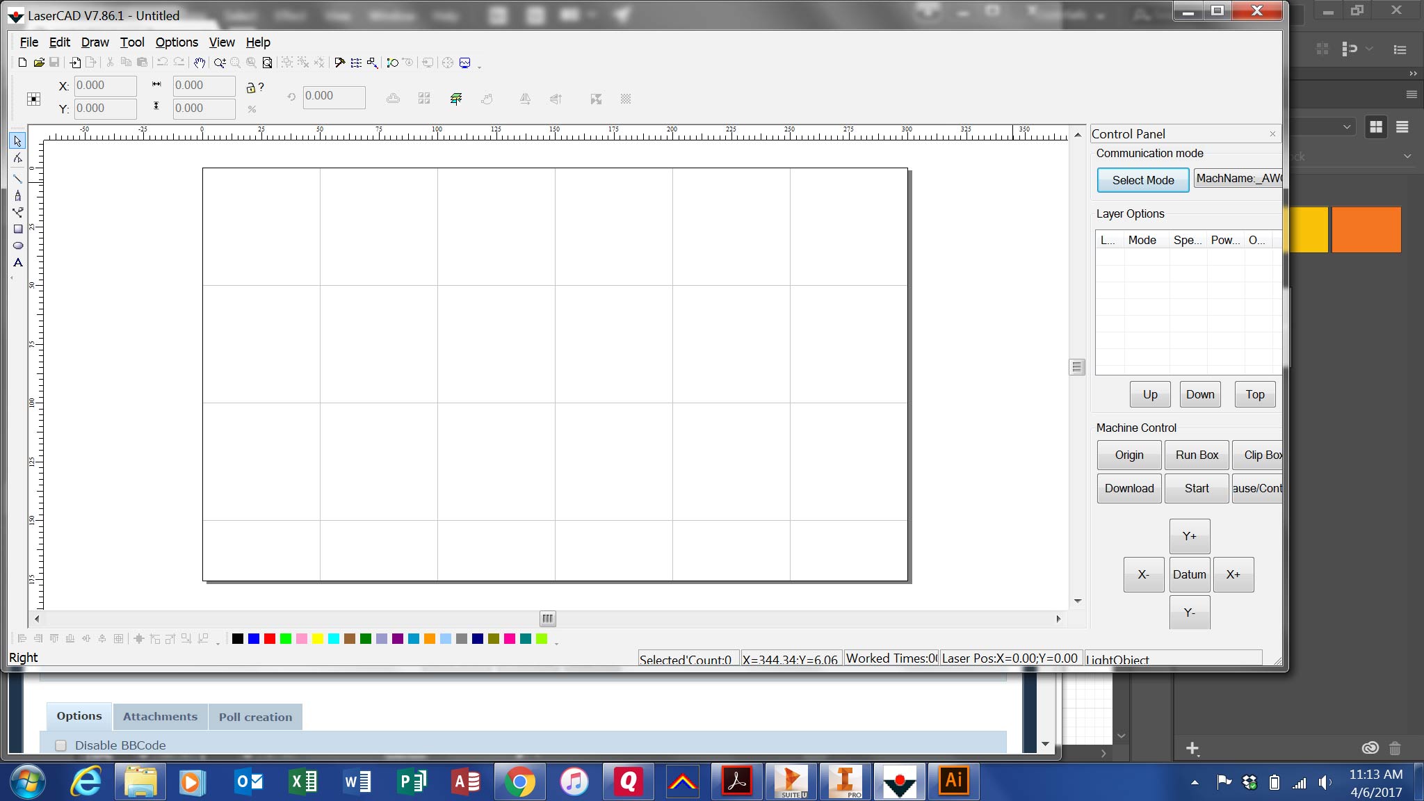

To fix the window sizing problem, grab the divider bar and drag it to the middle. It will stay scaled if you maximize the screen. I couldn't figure it out for days, then my wife said, "just move the divider". Sure enough, sometimes it is the simple answer.

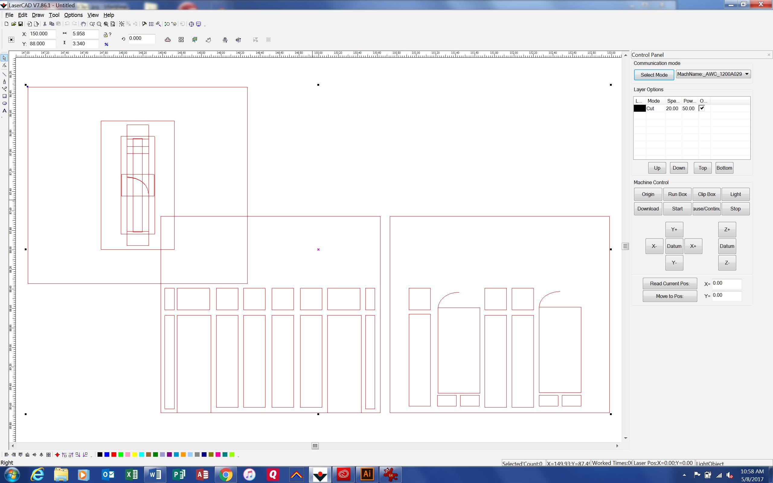

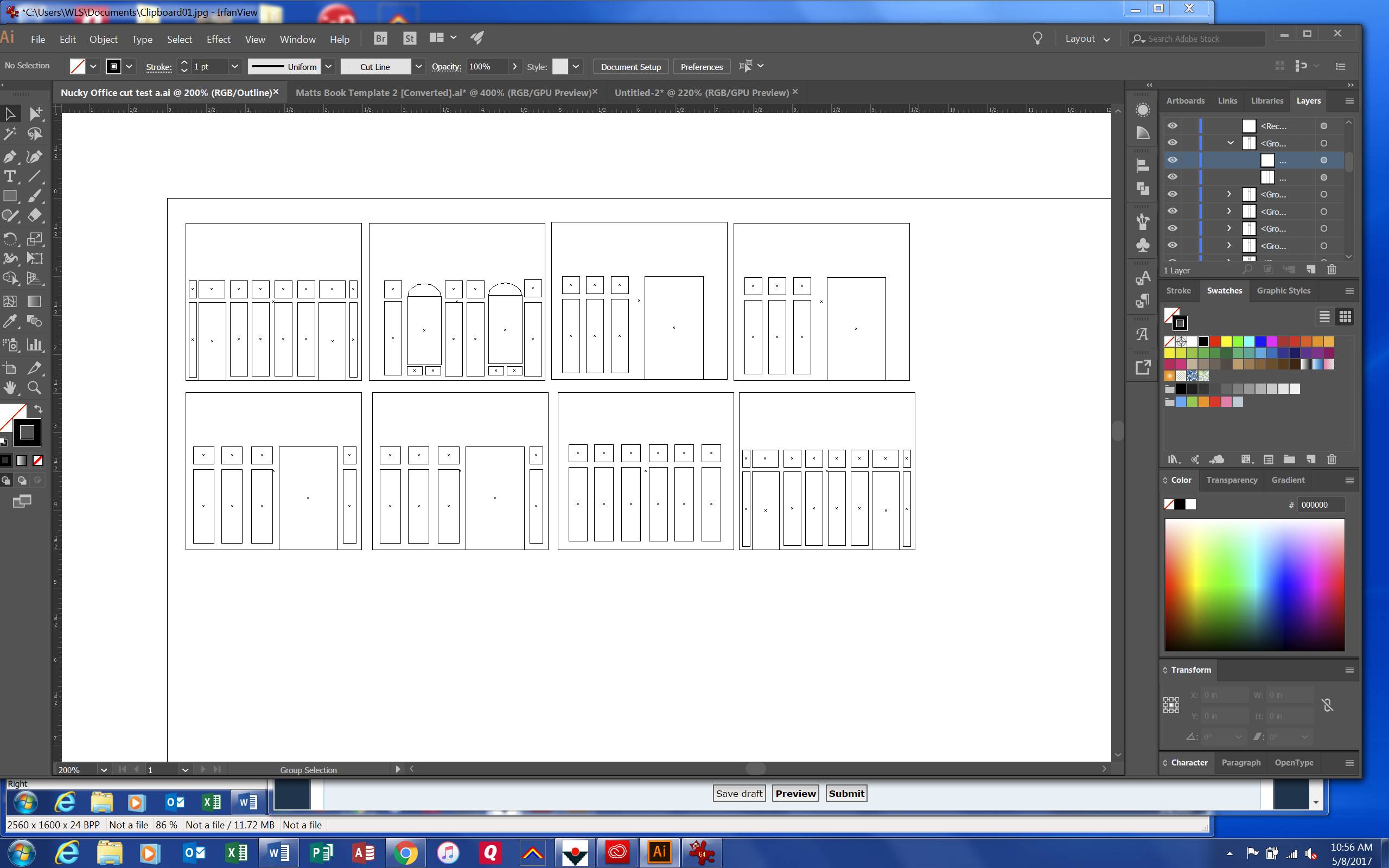

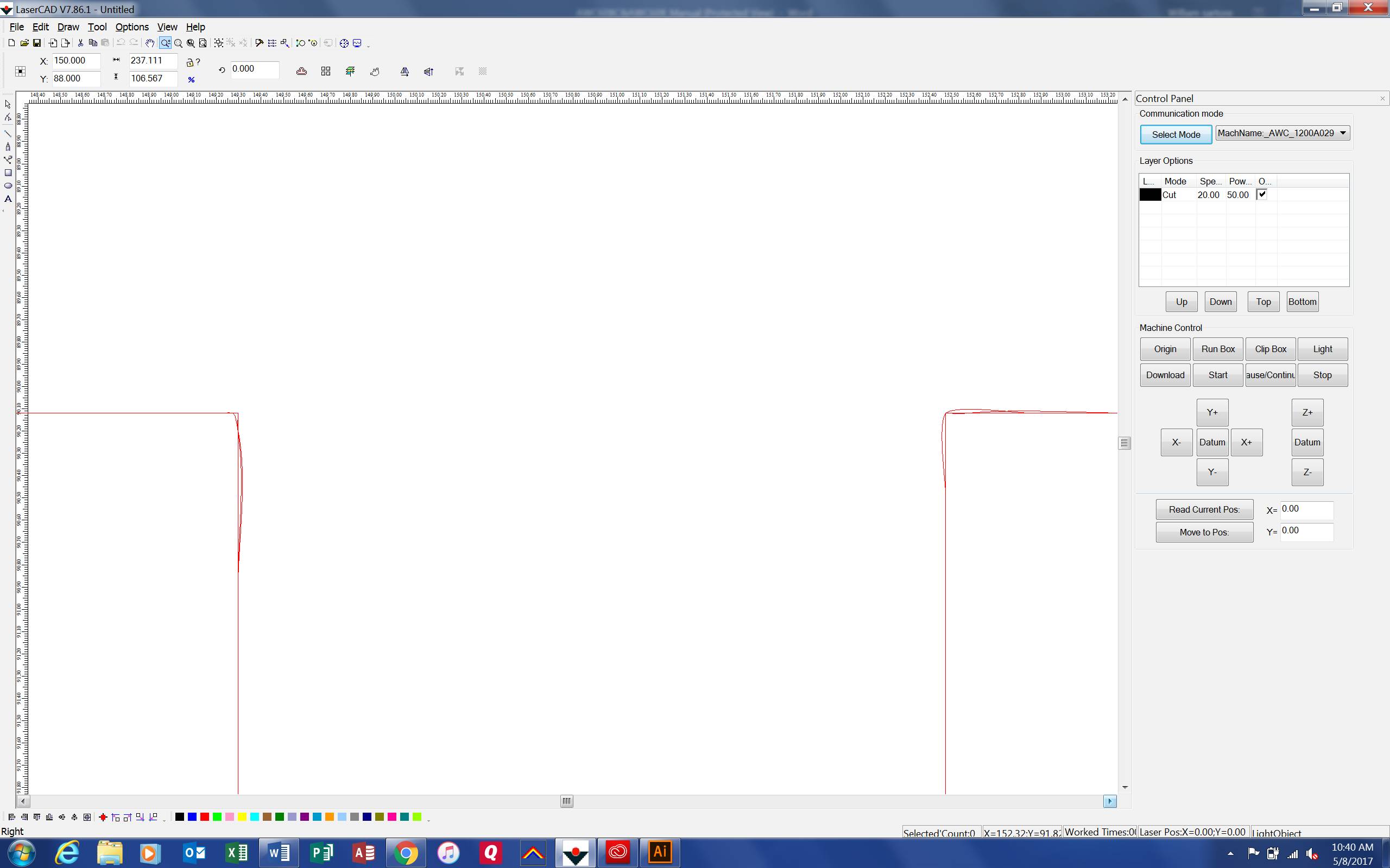

When I first made the ruling guide template I found there were a lot of repeated rectangles that I had to delete. After double-checking the latest drawing I made I find that it looks ok - no duplicated items on top of each other. After it gets exported (as AI Version 8) then imported into LaserCad the funny stuff happens - as noted by SWMS and Kees.
I've attached a screenshot from LaserCad. When the image is viewed full page it looks fine. I go to cut the file and find that it cuts fine then retraces the cut path two more times. The screenshot shows a zoomed-in version of a couple of corners. Resolution isn't the greatest in the image but I think you can see that there are some extra paths that got thrown into the soup so to speak.
Exporting to DXF causes a different problem - some rectangles/paths get stacked on top of each other and I'm left with something that looks like a Frank Lloyd Wright sketch.
I've attached some screenshots to help illustrate my problem.
