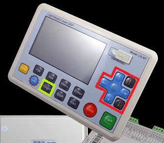

After turning on the machine it will go to its home-position first, right? this is essential! so you MUST have your homing-sensors right at first..
Then you can position the head somewhere on the bed using the cursor-keys on your controllers keyboard (marked red in the picture).. Does this work too??
When you placed it where you want your origin, you press ORIGIN on that keyboard (marked green in the picture) and the machine will return there after the homing-sequence at power-on.
When you press RESET it should go to the homeposition first and then return to the Origin-position ( the position where you pressed ORIGIN the last time)
It can be there is a setting to go the origin after power-on/reset, but i have to scan the menu's if i did that in the past somewhere..
