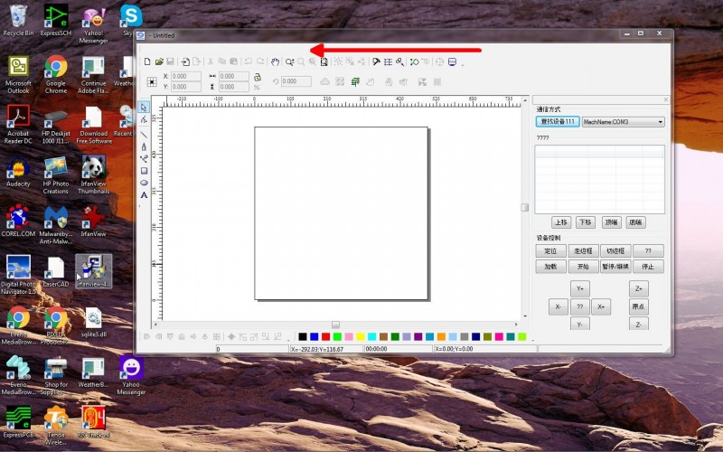

OK , I found a screen shot of the LaserCad V7.79.2 and it was in english, so I uninstalled the lastest version, back to square one. The IN downloaded the V7.79.2 version of LaserCad. Extracted the files using Z-zip program. Then after the files were extracted, I clicked on the setup button. A small screen poped up for the install and it was in chineese . I clicked on the Lasercad and then the button to change it to english and then hit the install button. The Install looked liked it worked, then I installed the USB drivers and after a couple of minutes it said OK. So I went to my programs list and clicked on Lasercad and started it up. When the screen came up, Again it was all in chineese See the photo below. Not only is it in chineese, but the whole top row of buttons for File, edit, draw, tool and such are missing See the red arrow. Can someone plese tell me what I am doing wrong. This is the 4th time I have tried to install an english version and all I get is chineese. Thanks Dan Stuettgen

by Tech_Marco
By default, it is in English. I guess you didn't turned off your antivirus program, did you?
Select English before click install
Uninstall the LaserCad, then delete the folder and run the installation again. Turn off the antivirus program just for a moment when doing installation
