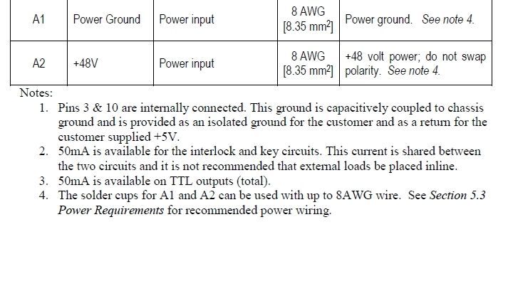

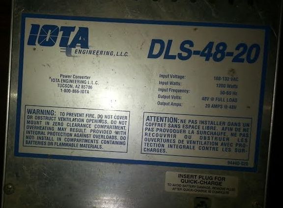

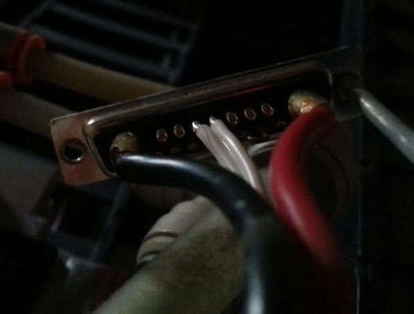

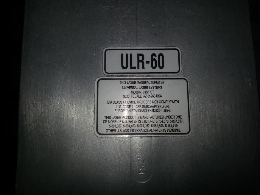

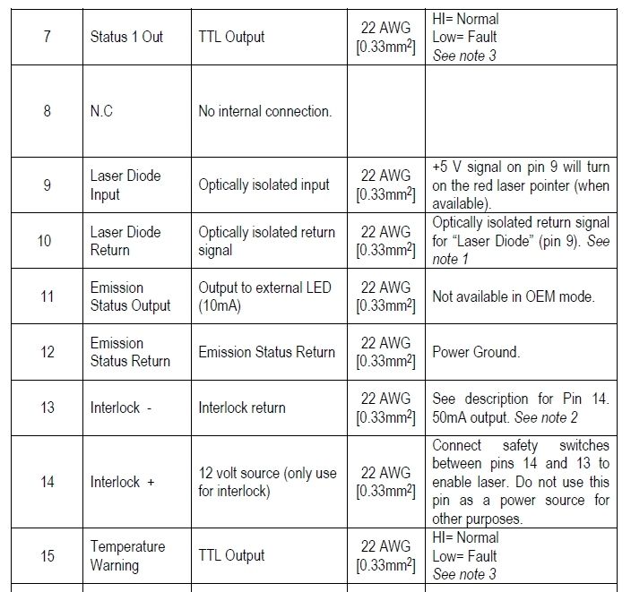

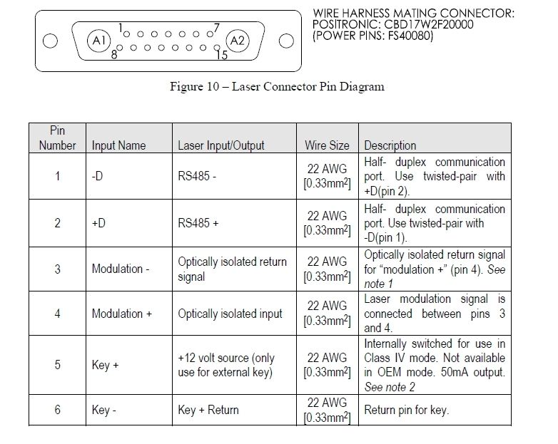

The laser itself is a Universal 60 watt Co2 laser with an Iota DLS 48-20 power supply (photos attached). Also attached is a photo of the wiring connection into the laser as well as screen shots of the OEM wiring diagram.
I am totally lost as to what to run from the TTL and PWM outs on the controller to the laser.
As shown in the connection photo, the only 2 wires connected to the 3 and 4 pins.
Can anyone help me get pointed in the right direction?

It look like that the laser you have is not a regular CO2 laser but a RF laser because the power sources is DC48V, instead of high voltage laser power supply (LPSU)

By looking at the block diagram, I think it is pretty easy to fire the laser by applying PWM output signal from the laser controller to PIN 3 and PIN 4. However, you do need to take care the Interlock and the other harness like the Key+ Key-. In most case, you may need to shorted this two pin to enable the laser, same thing happen to the Interlock.
I believe that by injecting +5V to the PIN4 with PIN3 to the ground, the laser will fire in full power.

Universal Laser is the brand name of the CO2 laser that is mounted on my table. I'm using the AWC608 as my controller. I was previously on a Kern setup, which is all proprietary software and hardware. Excellent if you buy it new, but crazy expensive to join the tech support/upgrade club.
