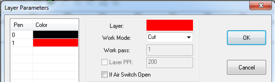

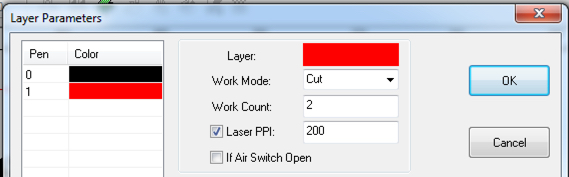

I upgraded from v7.36 to v7.43 and now unable to select PPI and Work Passes. They are grayed out in v7.43. Anyone else having this issue?

Find the "SoftCfg.ini"
Change the line "IfEnbleCountAndPPI=0" to read 1
Do this while LaserCad is not running.
