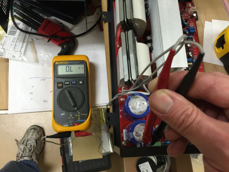

Posted: Mon Oct 13, 2014 6:00 pm
by MitchL
I'll find out shortly, but I think your suspicion was correct: The 110V/220V switch looks like it's faulty. It's definitely open, and when I wiggle the switch sometimes there is contact. It's definitely a problem, hopefully _the_ problem.
I'll jumper the pins together, reassemble and reinstall the supply, and let you know.
I definitely should not have put the nuts for holding the PSU in place on the _bottom_ of my machine.
/Mitch.
