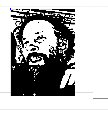

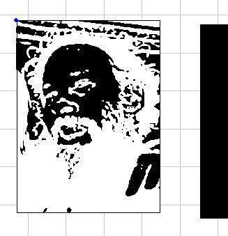

Here is a photo of the screen
https://lh3.googleusercontent.com/atug4 ... =s219-p-no
Here is how it engraved
https://lh6.googleusercontent.com/srCxi ... =s219-p-no

Here are larger images
and the resulting cut
