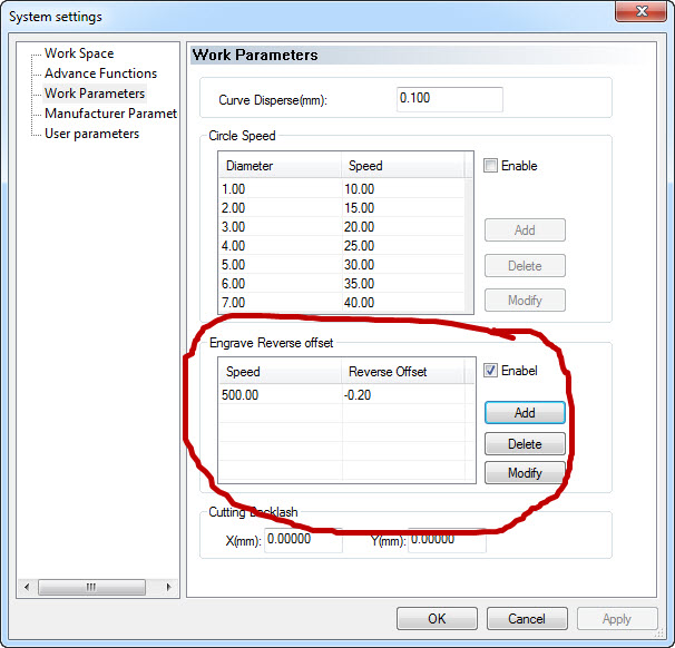

Re: Peculiar Engraving Problem
Hello junglebmx and Marco,
I have been doing bold engraving and didn’t notice the problem. Now I’m doing some very fine engraving and noticed the same problem you have described. In engraving small lines like script text, the point where the laser fires while traveling from left to right doesn’t match up with where the laser fires while traveling from right to left. A vertical line ends up looking like a zipper.
I have also tried very slow speeds so I'm confident backlash is not the issue. The offset is the same traveling fast or slow.
Is there some setting to calibrate the x-axis swing so the back and forth firings line up? I’ve tried adjusting the engrave acc. to various settings between 5,000 and 10,000, but nothing changes. Also, it does the same thing if I use the y-axis swing.
Glenn

Greolt
- Posts: 183
Look here
- 2-05-2014 8-37-43 PM.jpg (98.62 KiB) Viewed 2243 times
