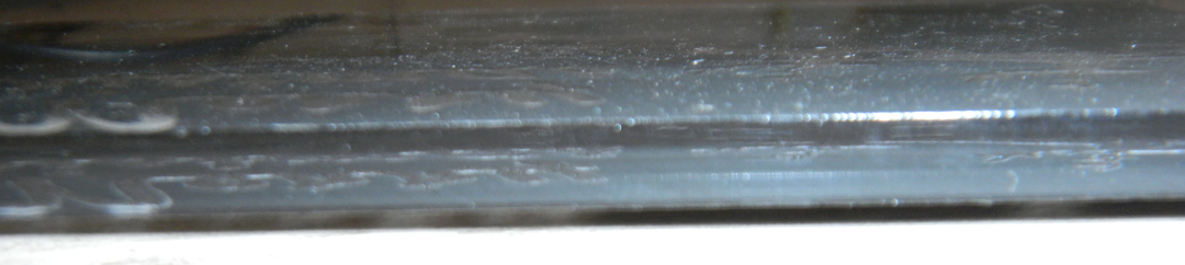

I would like to move my acrylic cutting workflow to higher level. Now I use a circular saw for rough cut, router to smooth the edges and hot air gun for melting the edges. I am pretty happy with results, this is 5 mm clear extruded acrylic edge:
Pros:
- perfectly flat edge
- no problem to process much thicker acrylic with suitable router bit
Cons:
- very very time consuming
- vertical and horizontal marks from router bit (sanding paper not used)
- limited to straight cuts
- chips while cutting/routing

to answer #1 if the machine has a DSP then yes the edges are crystal clear but needs to be a bit of sanding to smooth out the not feel able but viewable ripple
#2 6mm is pretty much maximum
#3 I will try to take a picture is not easy because anything's egraved will show thru
#4 no the laser cuts just straight
#5 yes you could with some afford upgrade to a 50W tube with a 50W power supply
overall you always would have the same raw edge
