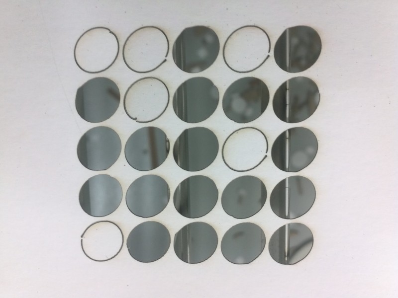

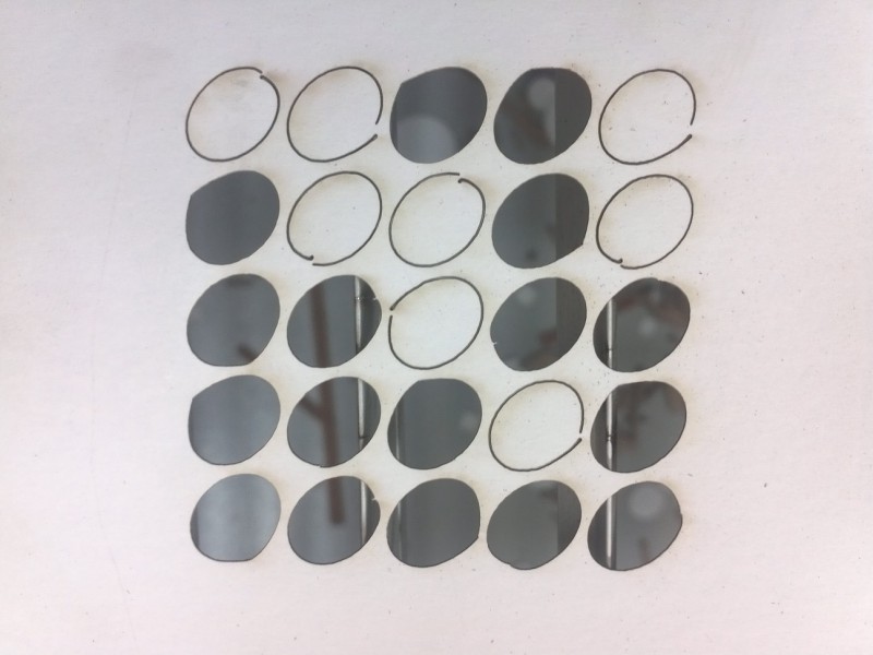

Hello everyone,
I ran into a pretty weird problem today, we just finished building 2 cutters with the 2012 DSP, both with the same exact hardware, one of them runs perfectly fine while the other shows the issue you can see in the attached pictures:
- Cut at speed 50mm/s
- Cut at speed 100mm/s
, the circles don't come out round!, I tested cutting an array of circles of 10mm diameter, perfectly round in the drawing and the result is awful, I tried everything I could think of to solve the issue, I checked for bad grounding, bad connections, switched to a previous firmware, changed encoder resolution, retuned the motors, but no luck, I noticed one thing though, the issue gets worse with higher cutting speed, the cuts in the pictures were made at 100mm/s and 50mm/s, the letters were cut at 100mm/s, if you look close the letters only show defects on the curves, the straight lines cut well, with accurate dimensions. Does anyone know what could be the problem?, as every other build we make this is for a client and downtime is a problem.
Edit, 2013/23/05:
I solved the problem!, it was the Y axis servomotor tuning!, it seems that the autotuning function of the Yaskawa servopack is not that good, I retuned the motor manually and the problem is now completely gone, I can vector cut a 5mm diameter circle at 100mm/sec and it comes out perfect!, thank you everyone for the suggestions though.

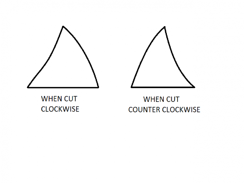

You're right, I tried a triangle instead of a circle and only the diagonal lines (where both motors move) show the problem, the result is something like this:
- result of cutting triangles
Notice the problem is reversed when I change the order in which the lines are cut (clockwise vs counterclockwise) from the results I think its one of two things: a) the X axis is accelerating too fast compared to the Y axis or b) the Y axis is accelerating too slow, lagging causing the line to be distorted, the amount of pulses seems correct as the height of the triangle is of correct size, this means there are no lost steps, I think it is the acceleration/speed that's not in sync or something like that, it actually could be crosstalk as you suggest, I'll rewire the pulse/dir lines with shielded cable just in case, now that I think about it I used the drives software autotuning feature to tune the motors, maybe it didn't do such a great job, I'll plot some graphs to check if the motors are following the command pulses correctly, any other ideas are welcome, this problem is really confusing me!

I assume the triangles are approx 10mm per side.
Cut them at something like 50mm per side. Same speed etc.
See if the resulting shape is the same or not.
My guess is that the Y axis is lagging but eventually catches up.
Elasticity in the belt drive or similar concept in the servo drive.
When a servo gets behind the drive feeds it more amps until it catches up. Unless it gets so far behind that the drive faults.
Too many things are blamed on "loosing steps". If steps are lost, you generally don't get them back by the end of the move.
