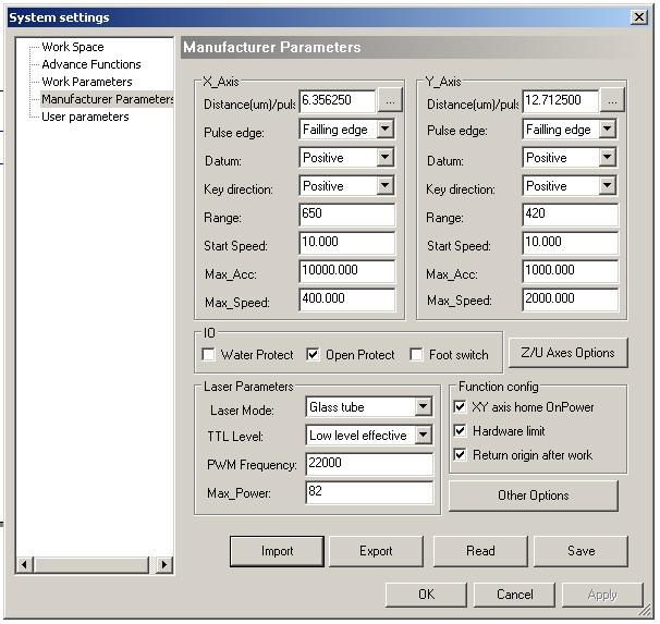

The max power is currently set to 82%.
Ive attached a screenshot of the manufactures parameters screen in case you can see something I might of missed.
Thanks for taking the time to reply.
- man prams.JPG (65.64 KiB) Viewed 3012 times

did you remember to save to the dsp? A few times I tried altering different bits to no avail then I realised that I hadn't downloaded it to the unit, so it was staying on the original specs.

try to set the TTL to high level effective
