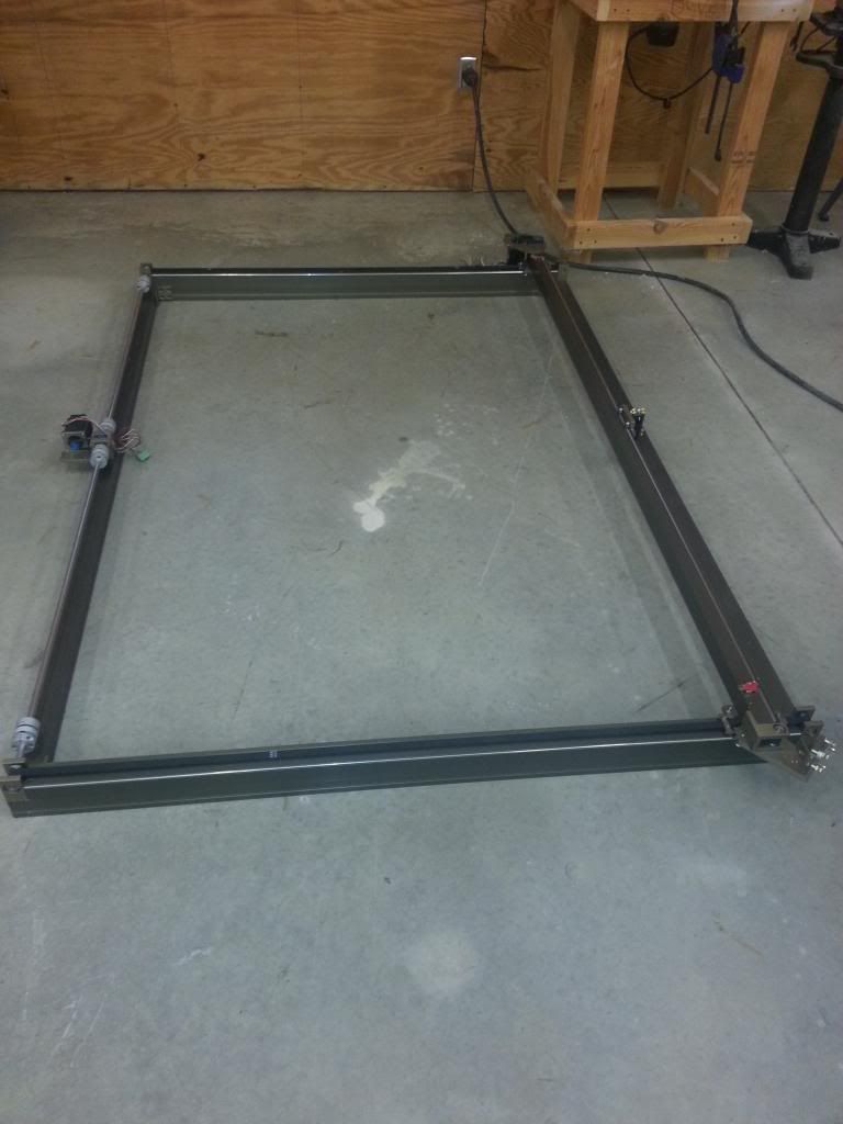

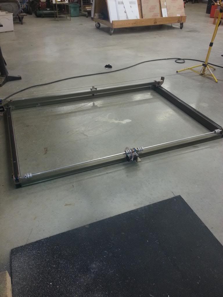

Here is the Gantry after being build. It is HUGE!!

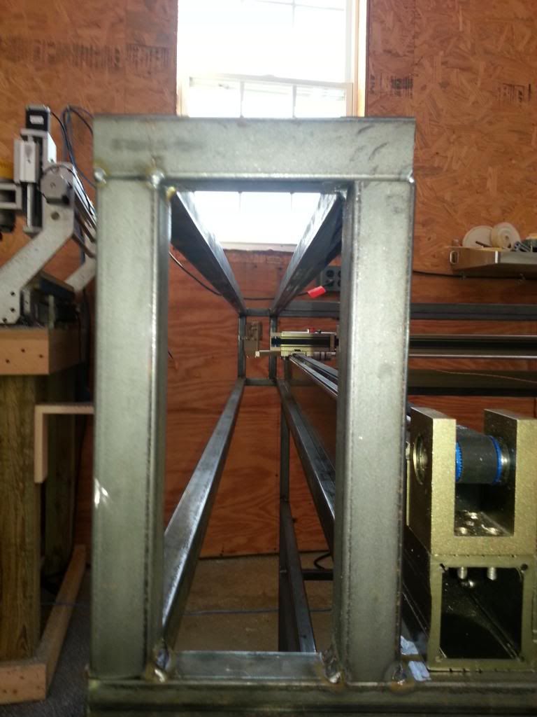

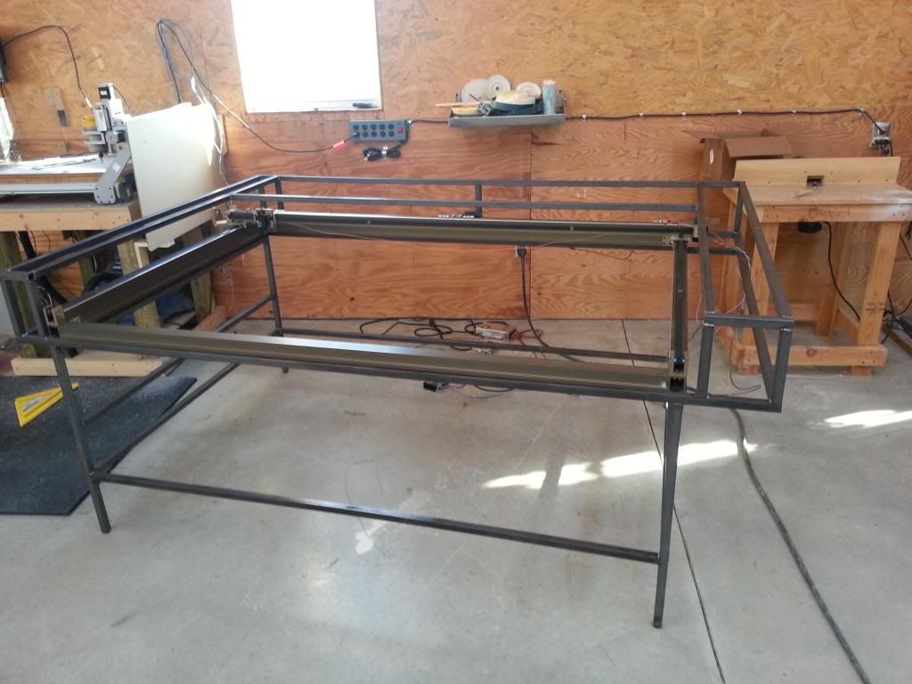

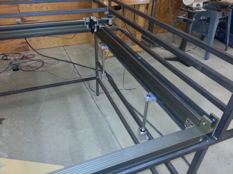

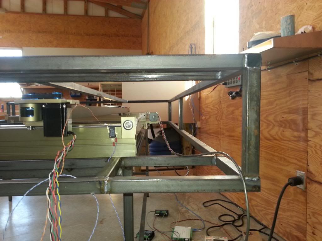

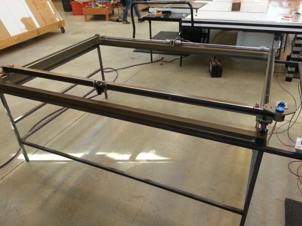

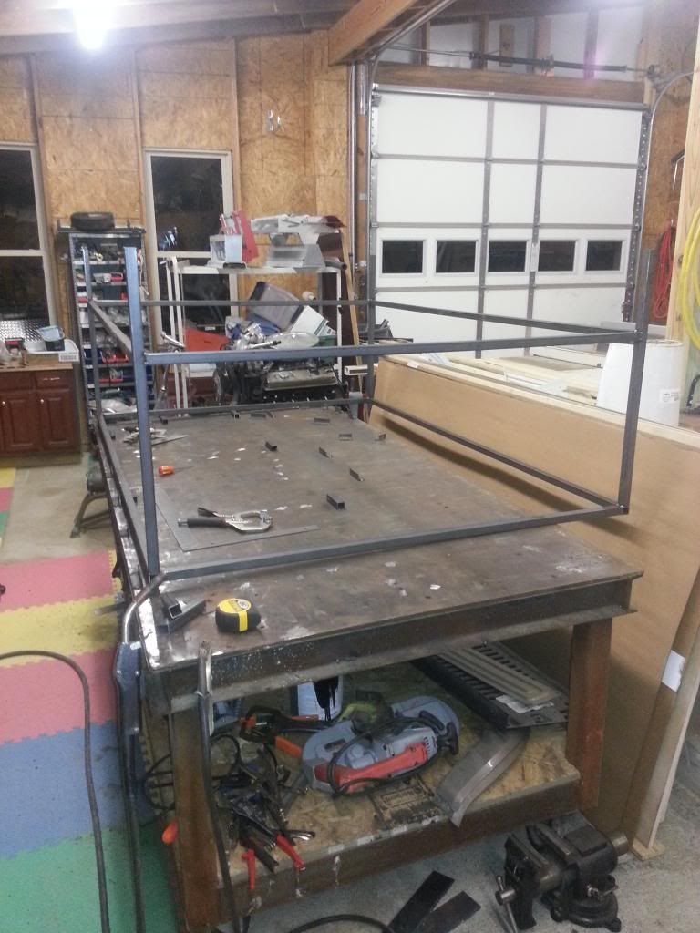

I have been welding a base frame for the gantry now. It will be 1" Box steel tube. Total over width is 95 3/4" x 68" deep x 30" tall. Here are some pics of the stand being build and the gantry being test fit.
Test fitting the stand.
The stand still needs the top extensions on the sides welded on. It will have a lid over the top center as well.
I plan on having a moveable Z axis that is being built out of 80/20 alumn.

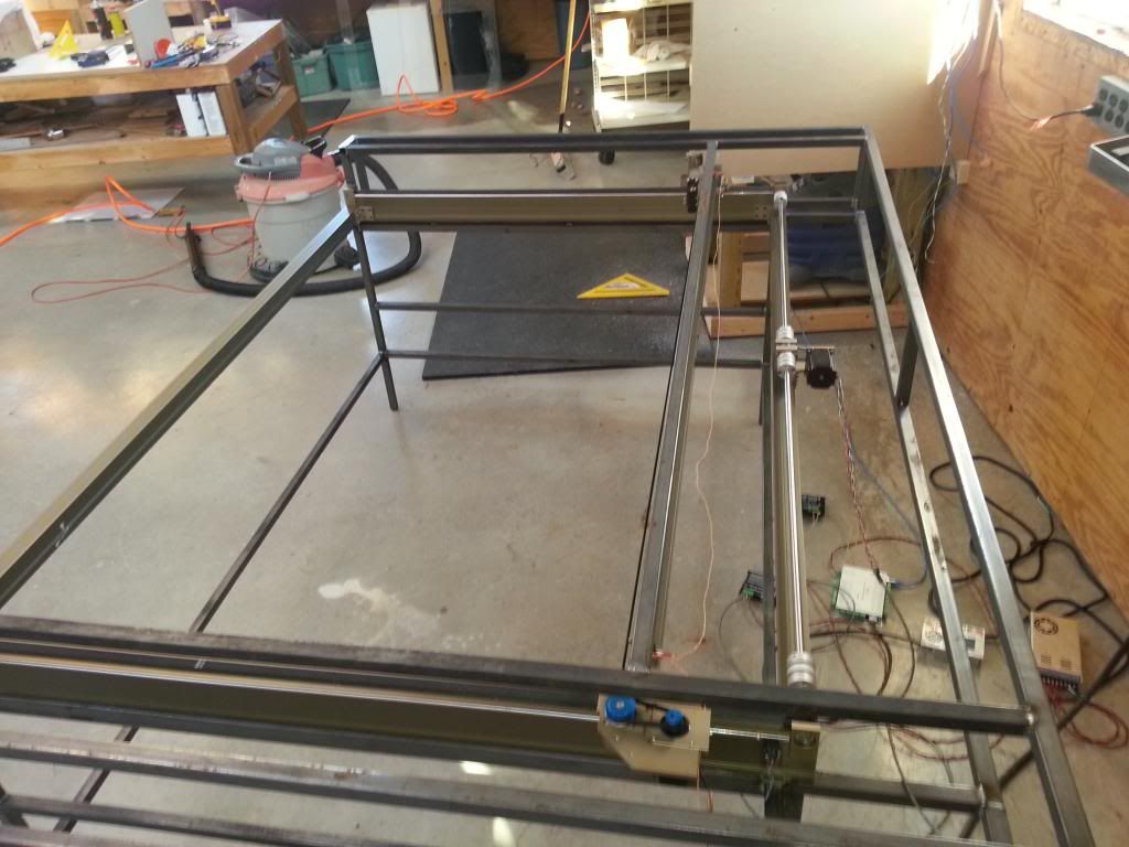

Here are some updated photos:

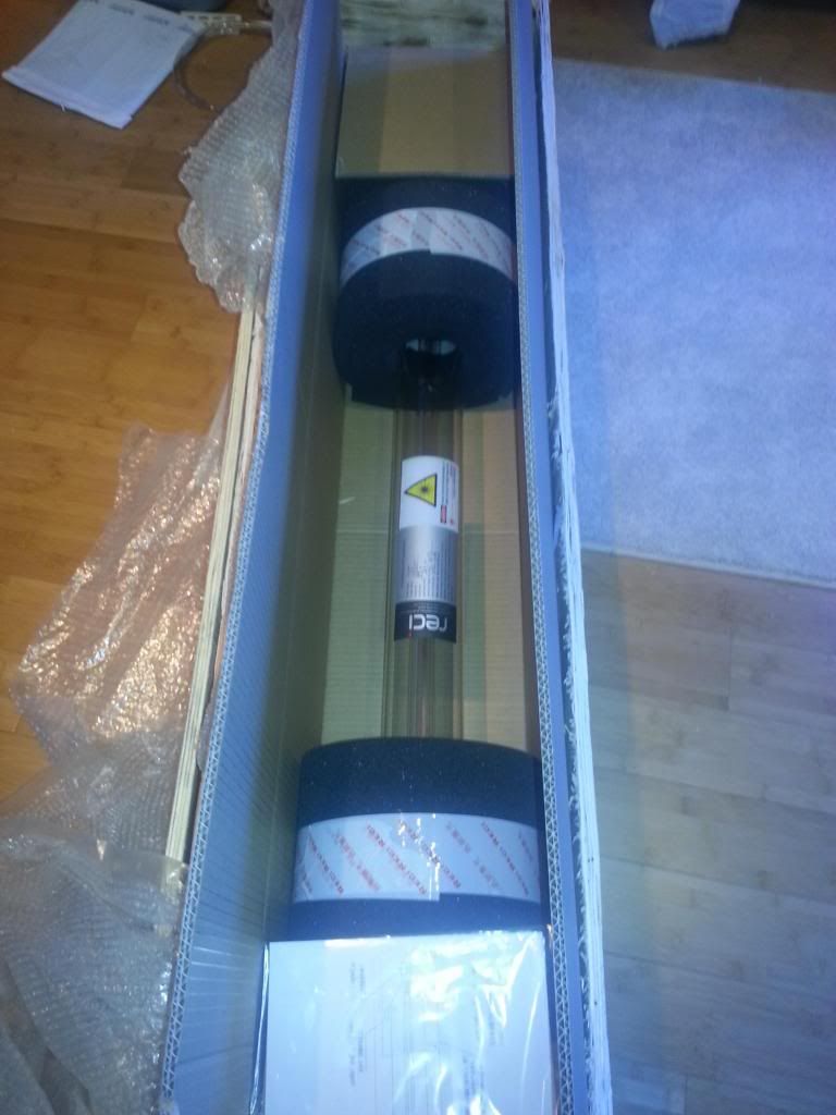

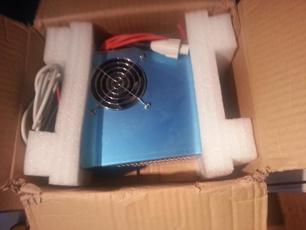

Laser Tube and power supply also arrived yesterday :mrgreen: It was boxed well everything arrived in one piece!!

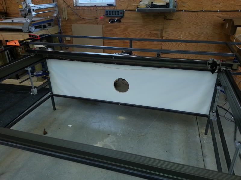

I and using 3/4" white melamine board and bolting it to the outside of the frame. This will also create the chamber for the exhaust vaccum for the main part of the gantry. This is adding a HUGE amount of stability to the frame and also adding a lot of mass. It is rock solid now even with just the back piece I have on it so far. I will then cover the top of the gantry with sheet metal to seal it up.
Here is a shot of the back piece on the gantry:

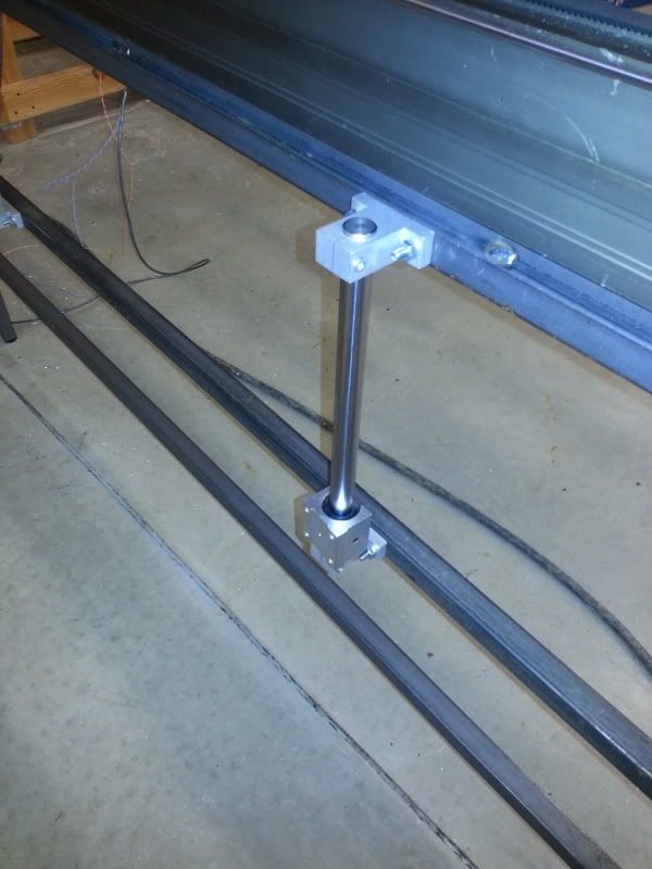

I was able to get the linear bearing and rods attached for the Z axis.

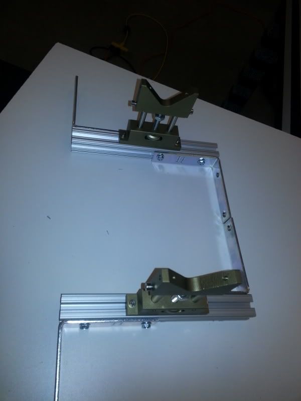

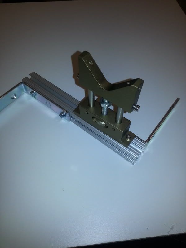

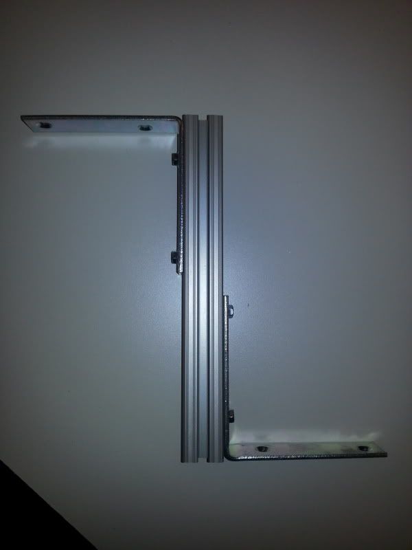

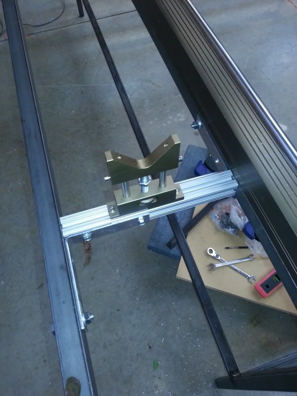

As for the laser mount and alignment I build 2 brackets out of 80/20 alumn. I then attached the LO laser tube holders on that. drandolph is sending me 2 of his laser tube holders that he made to slip over the stock tube holders. They should be here next week. Here are the brackets I made:
And attached to the frame:

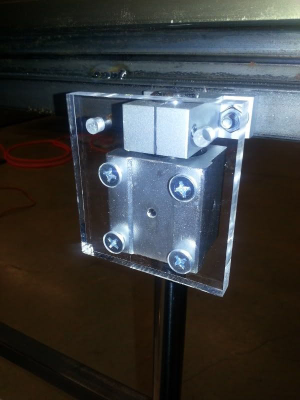

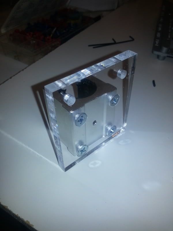

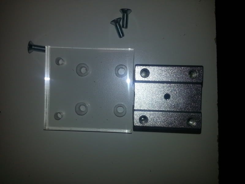

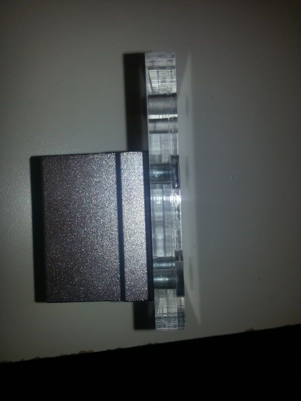

Was able to get the brackets done for my z axis. I CNC'ed 4 - 3/8" acrylic brackets to hold the 80/20 aluminum bed that I am building.
Mounted to the linear bearing:
