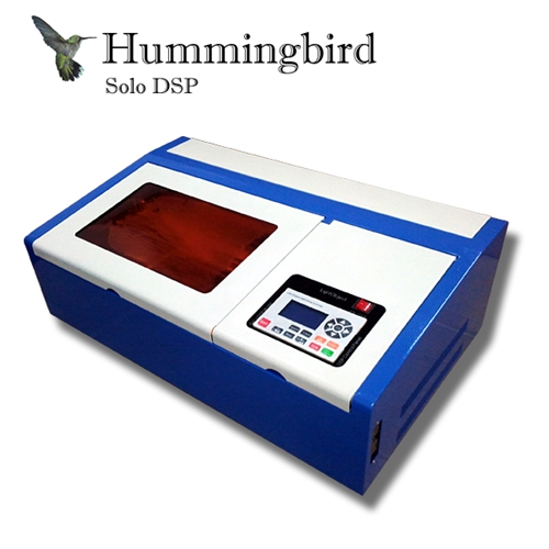

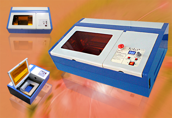

We imported some of those machine and performed some modification. We took the 'gut' out and upgraded it into two model: Solo G-code and Solo DSP. Plus, we re-worked the XY alignment, mirrors setup, fan, and water pump. Even though it look like similar, but it's no longer the same machine as the original.
Solo G-Code: it works well under Mach3 or Kcam. The system is driven by a custom made 3-axis stepper controller board (TB6560). This setup is good for folks who has CNC background with need of precise controlling on X,Y
Solo DSP: it is driven by AWC608 DSP controller and it's graphic interface guru. It's good for people not in technical background like those CNC guy but enjoy fast turnaround time by output image from CorelDraw, Autocad or most graphic image imported by the come with LaserCad.
