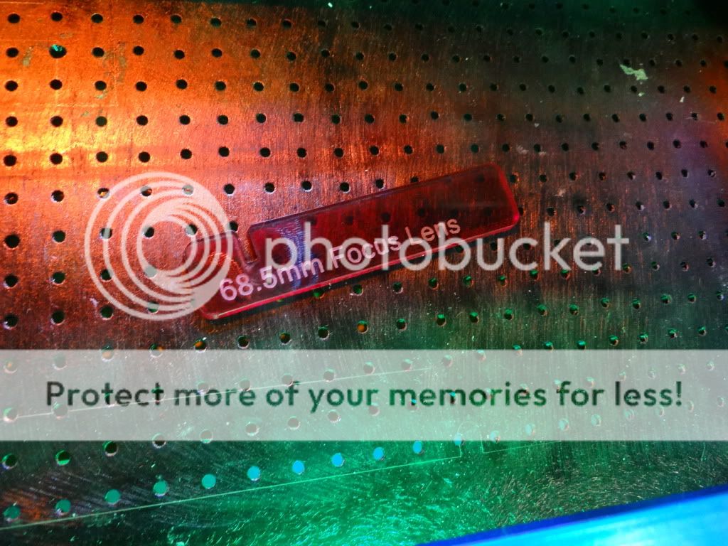

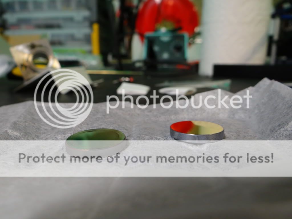

Got my new Lens with 50.8 focus instead of 68.5 that I have been using, which also works great but for 3mm plexi, I learned from the Pros on this site 50.8mm is money
Also got my Mirror Upgrade. 3x HQ Si Mirrors.

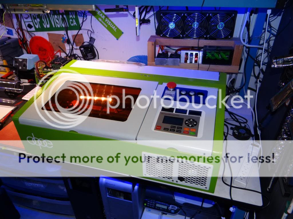

Just have some final tweaking to do and the only things that actual K40 are the XY stage and the laser itself. Everything Else is top of the line Light Object equipment.
Even as it stands right now with out the mirrors upgrade and lens this machine is so far superior of what it was stock it's not even funny.

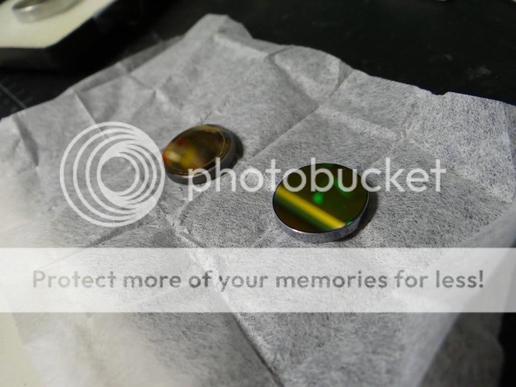

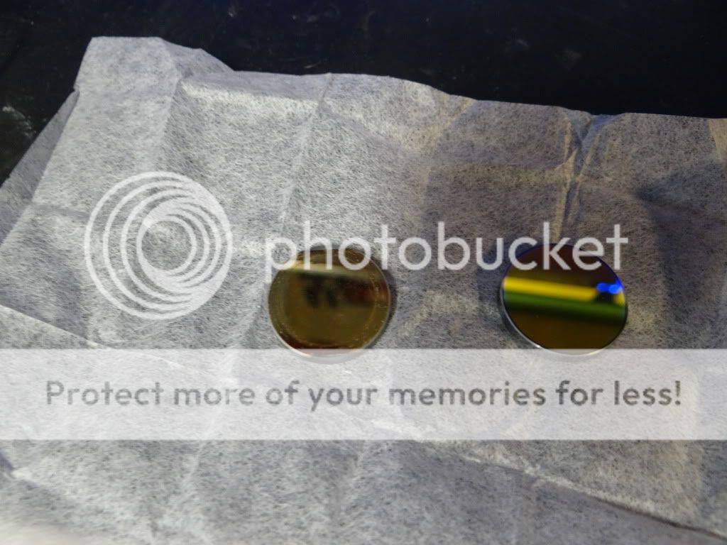

So I don't see many people post pics of this stuff so I figure I'll show you guys some HiRes comparison photos of the k40 Chinese parts next to Unmatched quality products that light object provides
This is 18mm vs 20mm and Focus 50.8mm vs 68.5

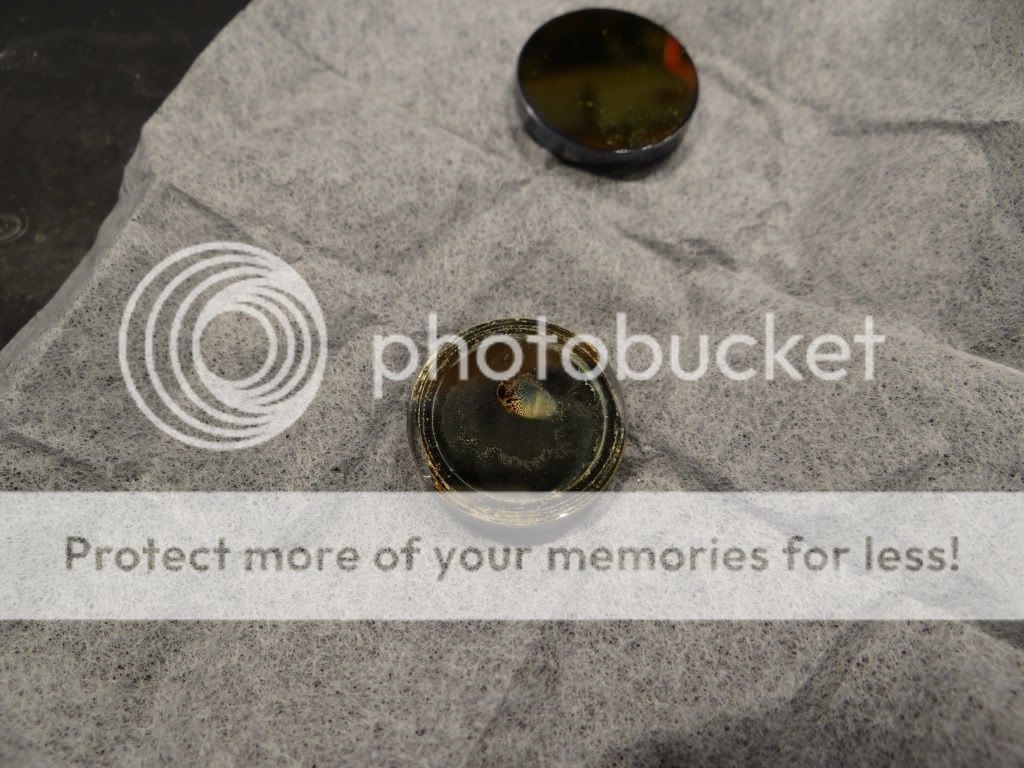

This is the reason I decided to get me mirrors the Mirror in location 1( next to Laser) was burnt and non salvageable due to the fact that at the factory they assembled the laser with distance from the mirror of less then 3/4 inch. Six month ago I didn't know ant better. Had no clue that the first mirror should always be at least 1 ONE inch away from the Tube. If not then you end up with what I have on my hands.

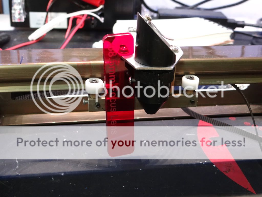

Also highly recomend everyone making themselves this little tool that allows you to quickly focus for prefect cuts

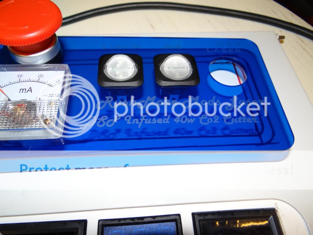

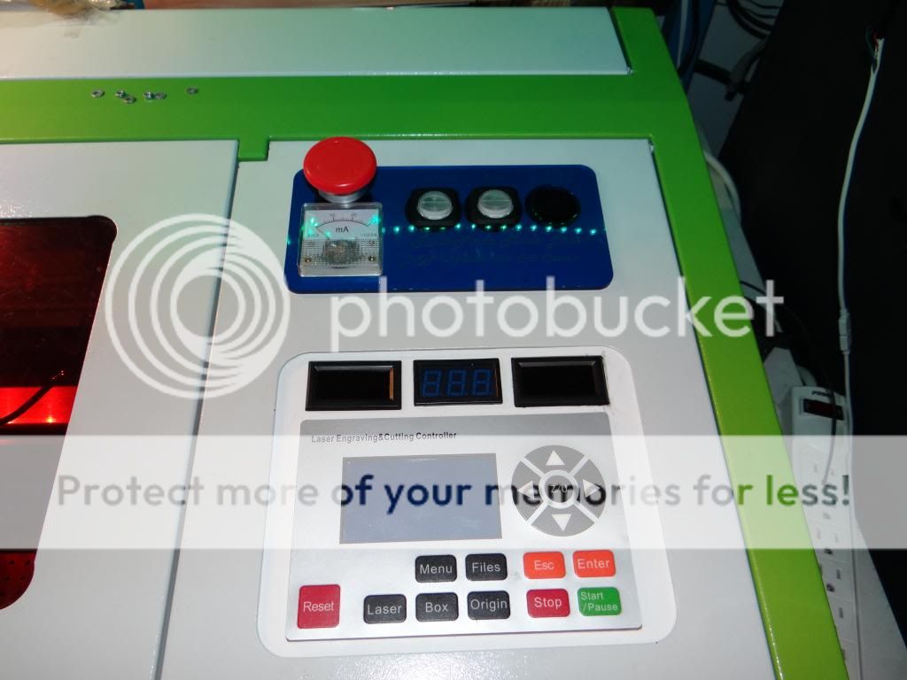

Hello everyone, i have yet anoyther little update to share with you guys, i have been changing some things around so that the machine can be more versetile and more apealing for someone else to use. so i have relocated all of the switches to the main panel so there no more switches on the water cooling end of it, also ordered some quick disconnects to the tubing so no need to drain.
anyway check out my new panel

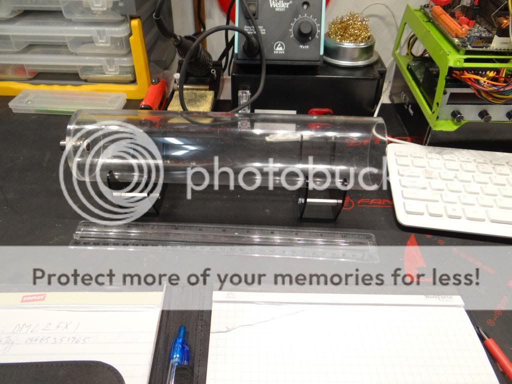

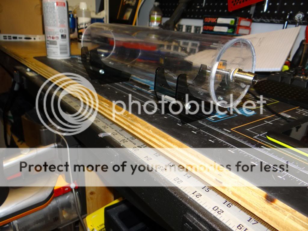

then i remember in the very begining some of you have showed concern over the very small size reservoir in my cooling system, i know the how days are coming so i decided to go ahead and make my own reservoir, ill show it mounted in a few days.

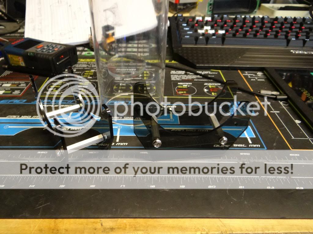

and these are the brackets i made on the laser

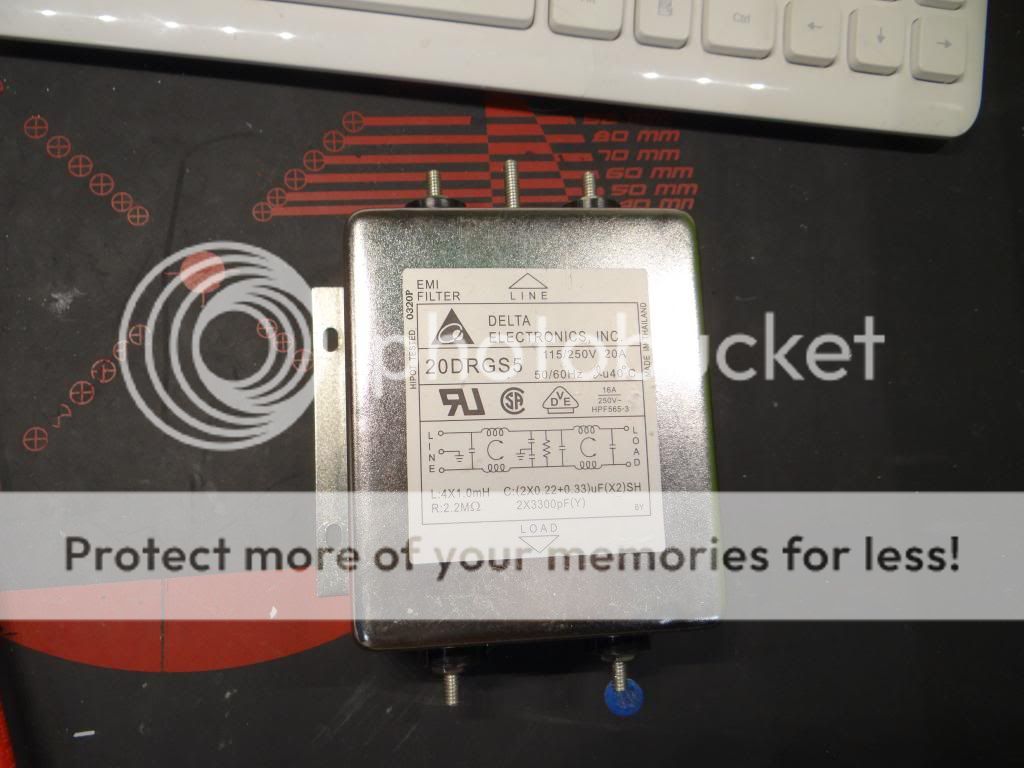

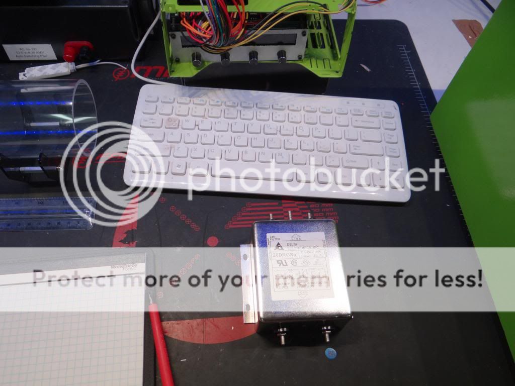

and finaly i have been noticing weird buzzing sounds during idle times, and just overall noise of the machine, so i went ahead and got the EMI filter, i didnt get it at LO i actually had one, its a 20amp, super beefy one, check it out, its huge
