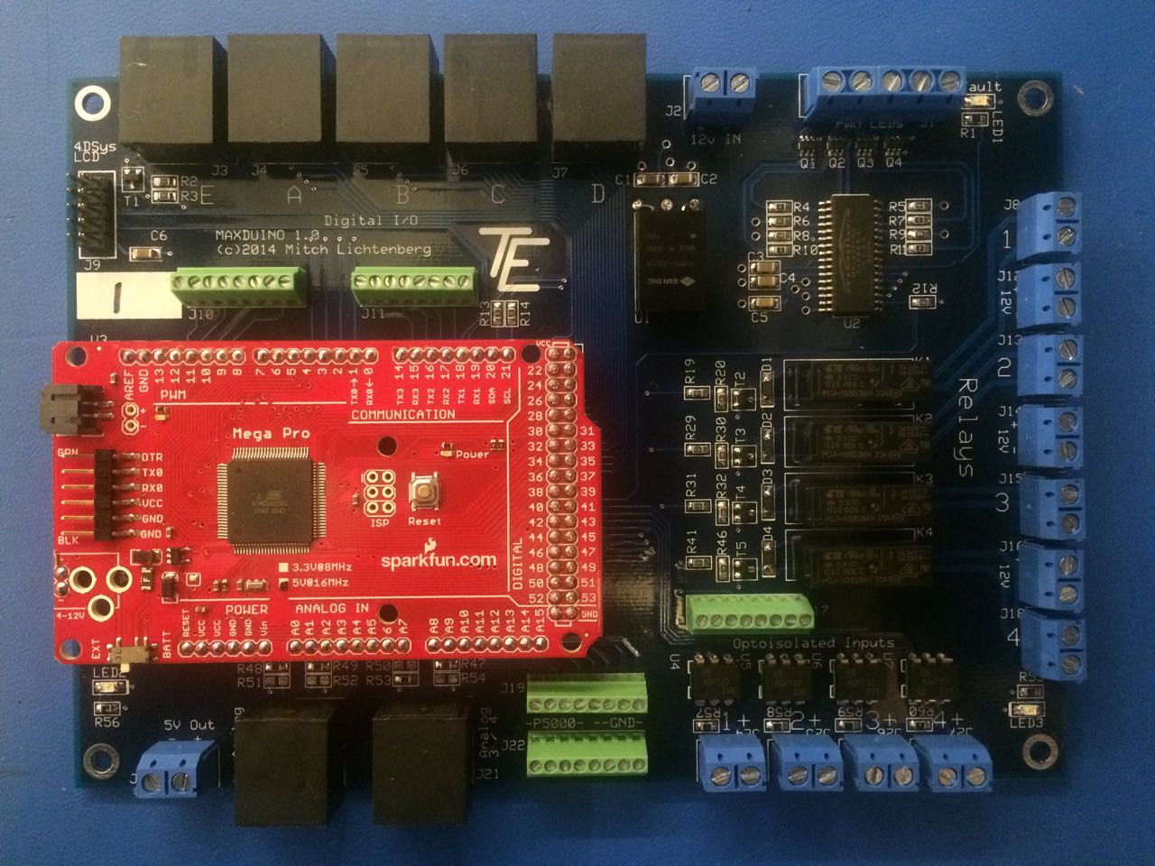

I'll dig up a photo of the LED strips or take one - my LEDs are from superbrightleds.com - part number NFLS-RGBW300X3-WHT. I've bought lots of LEDs from superbright in the past and have been pretty happy with their stuff.
The LED strips are controlled by a home-built supervisor microcontroller on my build, which is basically an Arduino with a bunch of relays, optoisolated inputs, and an RGB PWM controller on it. I can control the color and brightness of the LEDs, so it can be one color when idle, one when cutting, one when the red dot is on (to get better contrast), etc. This controller is the one that talks to the LCD to the left of the AWC on my build.
These LEDs have 3M sticky tape on the back and are attached to the underside of the gantry. The wires run through the E-chain to the microcontroller. I considered putting additional fixed LEDs, but ended up not doing it.
/Mitch.
The LED controller and connector are in the upper right corner of the board.
Maxduino, the laser supervisor

Yeah, a 30-pin micro is pretty overkill for running LEDs.
