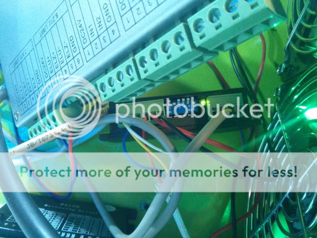

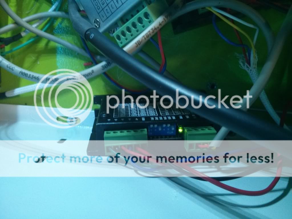

man i am seriously starting to loose hope here, i have rewired the machine, and still same outcome, they want to move, they sound like theyt want to move but nothing

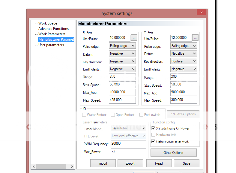

Re: Rookie at Laser, NEED stupid questions answered
Post the DSP setting see if anything wrong.
Also, what is setting on the motor driver?

ok thgis is the X
and this is Y

By the way, both X and Y should have the same (or closed) "um". 10 and 12 is a lot of difference. Use 12.5 on both

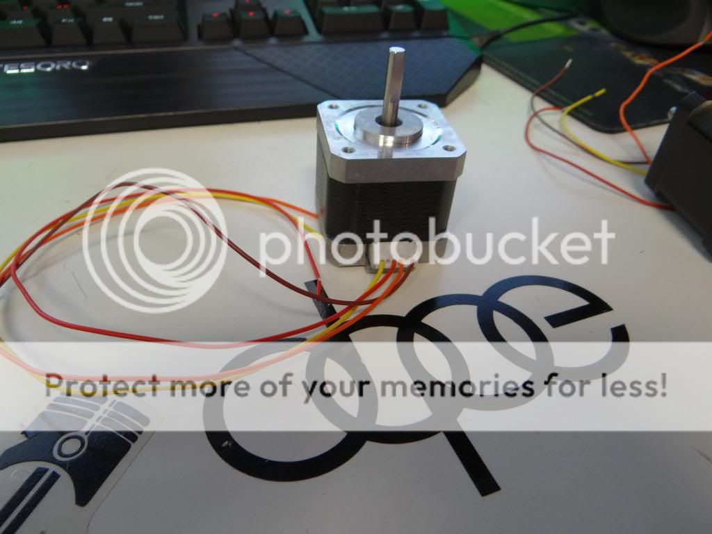

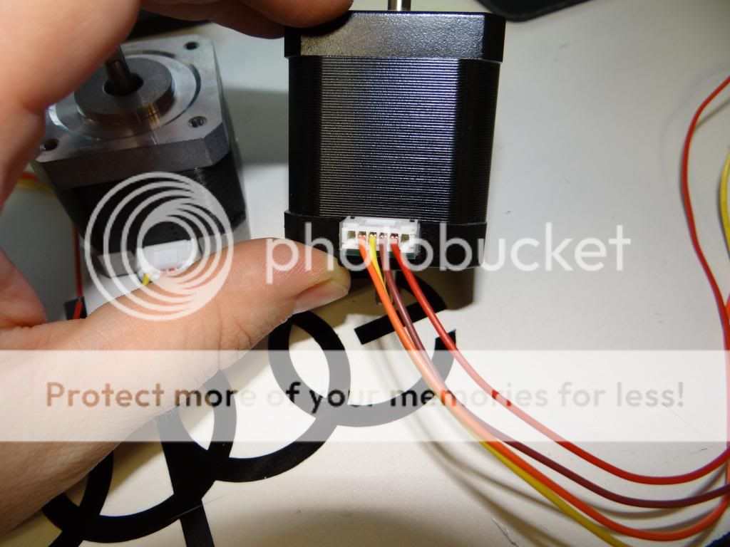

ok thank you for your help so far, so i finaly got back home, and the motors i bought from you are here, i just dont want mess anything up so can you please direct me to the proper Pin/OUT on the motors( what does each color mean)
SO here is what i gathered from you store information please answer the questionmarks, please

PIN-OUT: from left to right
YELLOW:???????????
RED: ??????????
ORANGE:?????????
BROWN:?????????
