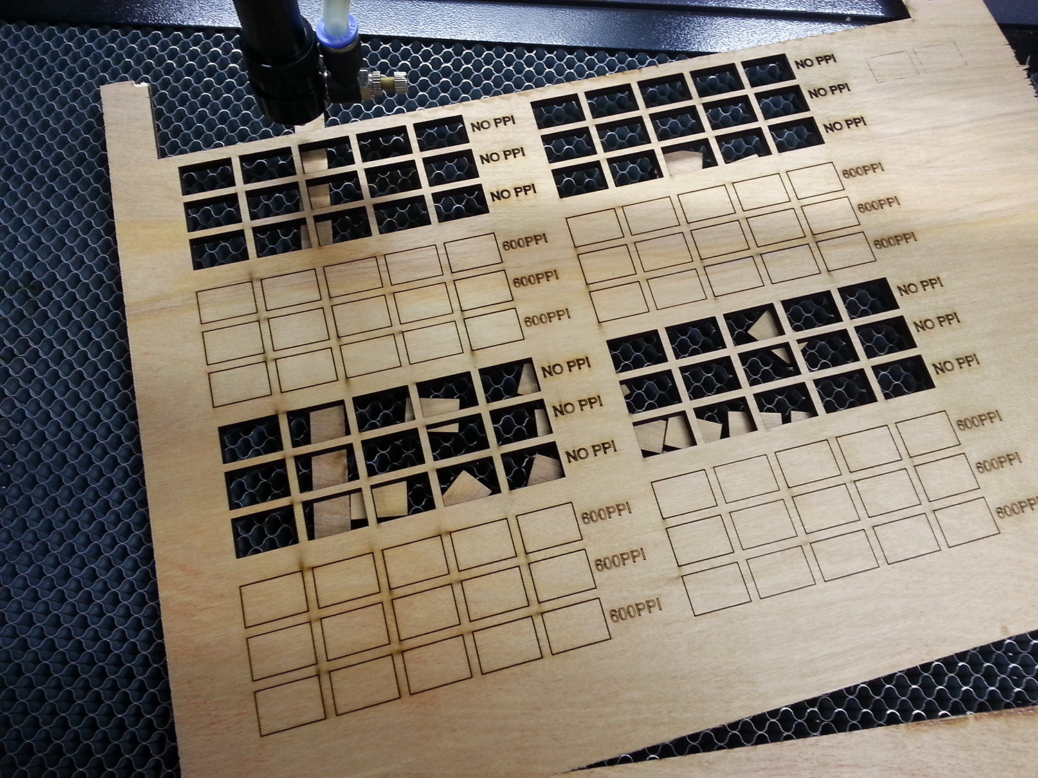

Melissa, I did try PPI and no PPI on your returned tube
It worked great. I could do both engraving and cutting
PPI could show less power and you need to raise the power on Max current set up
I was using speed 30mm/s speed and 600PPI. The I used 400~500mm/s on engraving. Power was set 15% and 20%, roughly reflecting 5ma current. I could hear some sounds when burning but it cut clean in cartoon paper
Also, I could cut through 6mm pine wood at 8~10mm/s at 18mA
Today I will do one more test: let it do cutting for over 10min. with and without PPI. If no brokn line happened, I will return the tube to you.

Testing update:
The process took over 16min to complete. I didn't see any missed fire or abnormal behavior.
The tube is great with very fine laser beam spot
