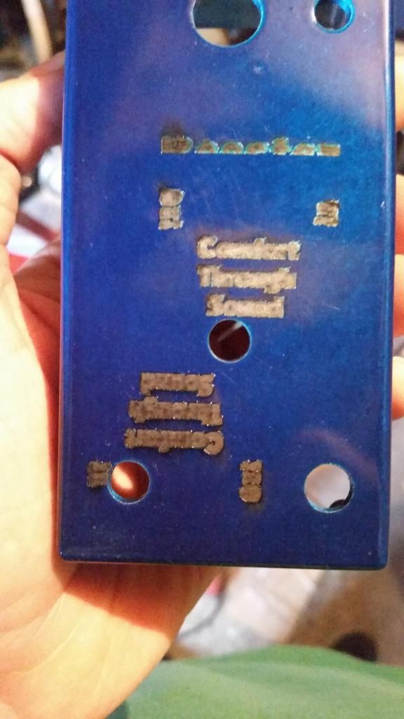

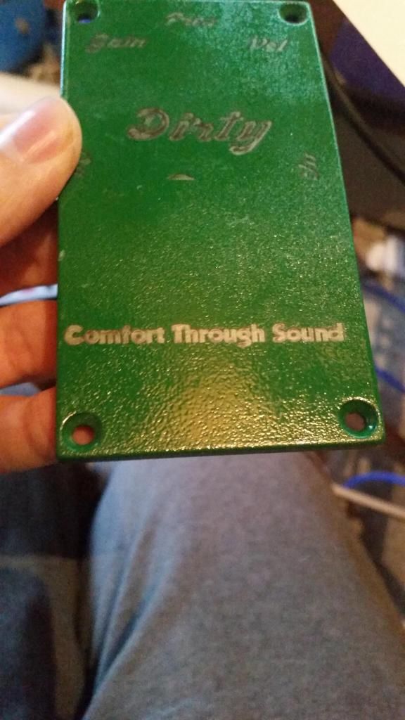

Had a bit of time to play with the laser today, and still not getting great results.
Marco - here is a picture of the text from my machine,as you can see, the paint between the letters isn't there for some reason. I've tried slower and faster speeds, stronger and weaker laser strength, but nothing seems to work. The font and text are the same size as the one on the black box that was done in a local laser cutting place.
However, when the text is very slightly bigger, it seems to be ok.
But when I did it as part of a full label, all down at the same speed and power settings, the label is getting there, but the bottom bit is burnt and missing the paint between the letters. Again.
On this one, you can see the writing on the right hand side, the writing was all done at the same speed and power settings, when it gets below a certain size, it causes the same problem of burning and losing the paint between the letters again.

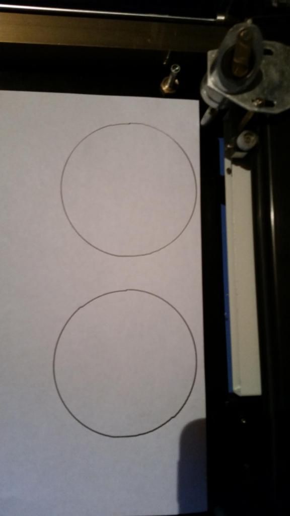

Also, with the circles, they still aren't right. The top circle is done at 100 speed, and you can see it's got a flat spot on it. The bottom circle is done at 50 speed, is a lot better, but at 10 o'clock and 4 o'clock, you can see notches or bumps in it. I've changed the rising edge and falling edge settings, got the focal point right, done the um value, and no I'm completely stuck on what to do next so any advice would be great,

I think you may having four issue:: 1) Beam alignment or focus 2) Belt or wheels may be damaged. Check the axis coupling see if it got lose 3) Bad motor 4) bad drivers

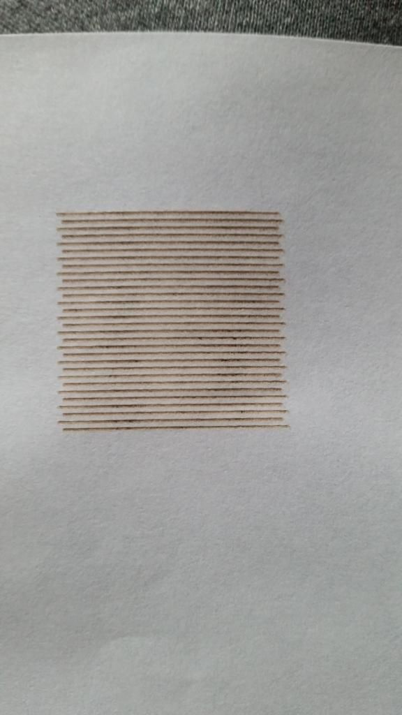

Draw a solid square 30mm big.
Set your lines per mm to about 1. We are trying to see if all the start and finish edges line up so we don't want all the engraved lines to be bunched up next to each other.
Engrave the square, not cut, on a piece of thick card stock that shows up the laser lines well at your preferred speed. You can try fast or slow to see what happens and any differences that may occur.
Look at the image and see if all the edges really do line up. If not then you have a problem with something being loose.

I'll try and add some more information here, the picture in the previous post with the circles is rotated 90', no idea why, but the bumps in that circle happen everytime in exactly the same place.
Marco, I've done the beam alignment twice, but putting in a bit of cardboard at an angle, and then seeing where the smallest point is. Each time has given me the same result, and I've cut a bit of acrylic that measures the distance for me now, and I'm pretty sure that's correct. I've also checked the belts and wheels, and to the best of my knowledge, they look fine (I put a light on them and moved both the X and Y axis, and they all look fine, no damaged teeth on the belts or the cogs). I've also tried moving the X and Y axis frame, but it's bolted solidly to the chassis and doesn't have any movement from it being loose. I've got absolutely no idea on how to check the motors and drivers for any faults though.

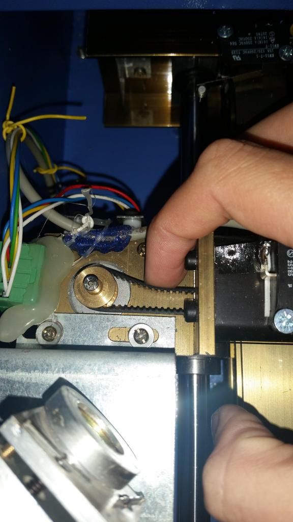

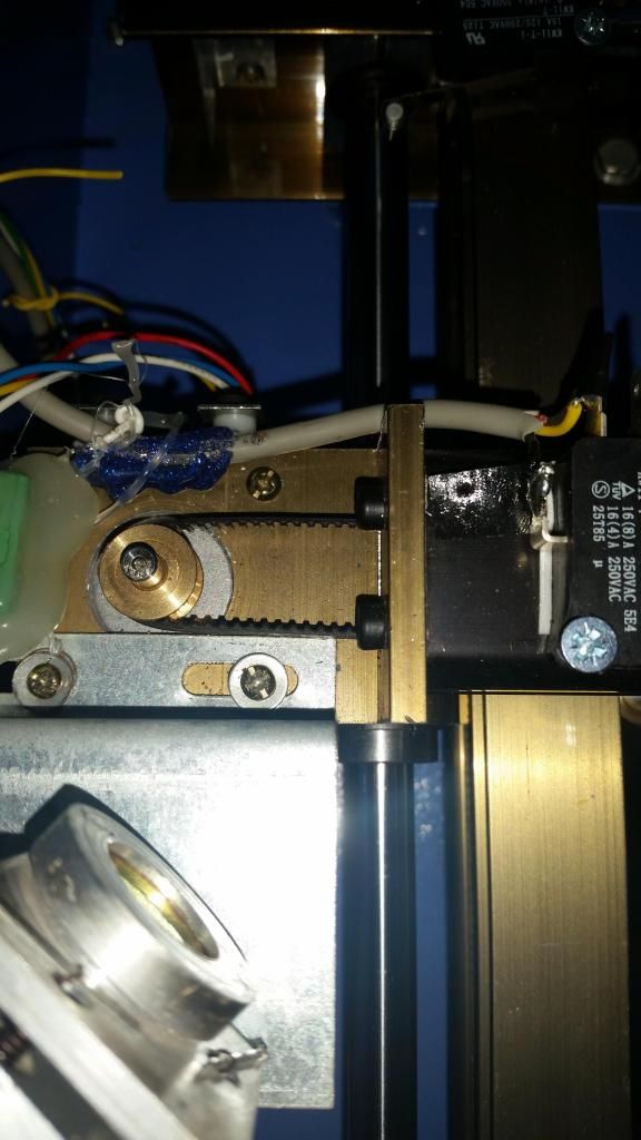

I've got a couple of pictures of the belt on the X axis (the one that goes left to right, that is the X axis isn't it?). As I've got no experience in these things before I started this project, I've got no idea if the belt is too lose or not.
Rich, I've drawn a 30mm square, and set the engraving lines to 1mm, and I've posted a picture of the results below. I tried a few different speeds, and each time it came back with exactly the same results. Also, the lines furthest on the left is when the head is going from left to right, and the lines furthest on the right happen when the head goes right to left.

That belt looks to be loose
Re: DSP works!
Definitely a loose belt or pulley. All those line should have the same start and end point. That's why all your fonts look so wide/thick and squashed as the lines are so close together you can't see the start and end points of each successive line and it appears wider than it should.
No good setting up backlash in software either as it will happen at any speed and won't be regular so that won't help. That is a very good test to see what is going on with belts, focus, and general misalignment.
The belts should be tight enough so that they feel firm when pushed on but not tight like a guitar string. If too tight it will just wear out your belts too soon and put undue stress on your bearings. The one shown in the picture should only be able to be moved about 4mm to 6mm sideways. Your pulleys look like they are pressed on so that shouldn't be an issue unless one is loose in which case you will need to put a drop of loctite on it or replace it with a different one. ( but I doubt it as they are usually a pretty darn good tight fit)
It doesn't look like the focusing lens is very focused either. I would expect a lot finer line than 0.25 to 0.5 mm in width (just by looking at the pic). I reckon mine is about 0.09 in size or around 0.004 to 0.005 thou.
And yes, the sideways axis is commonly referred to as the X axis
Also with that style belt XL or MXL you have flat sides that want to ride up the sides of the pulley if loose and that is why I only use the HTD round profile belts now. All the photocopiers I have pulled apart for parts use HTD belts and they last millions of cycles and that's why I use them. I'm not saying to change the ones out on your machine, just that I don't think they are as good as round profile, so you need to keep them taught.

How do I go about tightening the belt? From what I can tell, I need to remove the X-Y axis as the belt runs under the X axis. With the HTD belt, if/when the current one wears out, I'll look into getting one.

to tighten the x axis belt go thru the hole on the right side , there are two screws they are for tighten the belt so easy.
