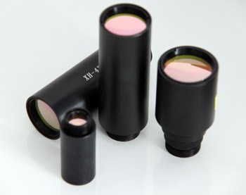

Update: Picture for the 2x...8X beam expander
- BeamExpander.jpg (13.24 KiB) Viewed 4466 times

I ended up getting a couple of glass lenses that are made for the more powerful hand held lasers and need to be made from glass or they will melt.
I have only used it twice but I have used it at 3/4 power and no problems whereas the old acrylic lenses would only last a few minutes at 1/2 power.
It is a much better improvement over the old ones.

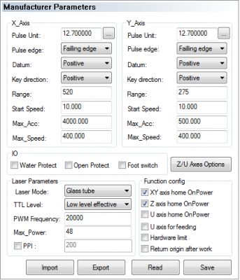

Hello bluewave65
If you're keep using this kind altitude, sorry I'm going to answer any of your question. You sounds very rude and demanding. Your works are lack of respecting and very insulting from here and from the buildlog.net

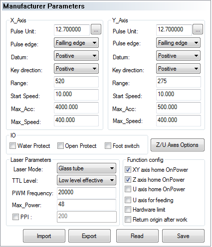

Anyway, you didn't check "Return home after work", that's why the laser head not moving home .
Correction: The pump stop after all jobs completed regardless the location of the laser head.

Re: Air Assist connection
Hello bluewave65,
If you look at the check box just above the "READ" button at the bottom of the screen you will see it marked "Return origin after work"
As Marco said, this should get you up and running.
