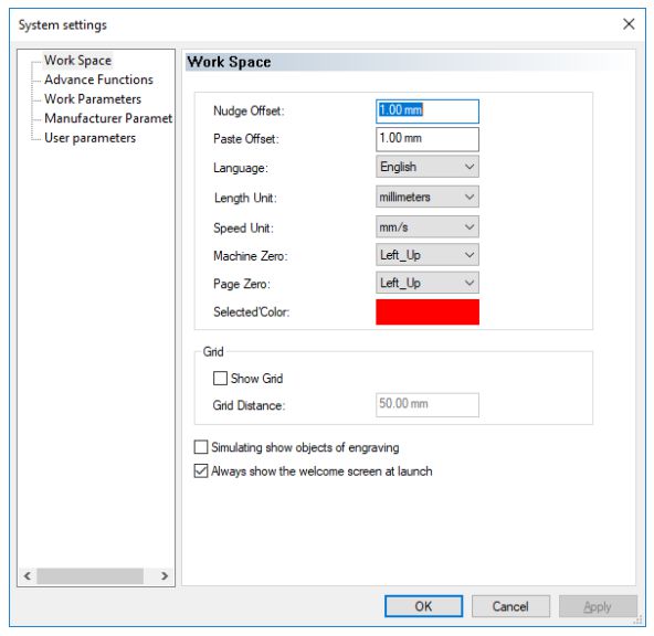

Ok so for a day or so it was just fine. I felt like I could cut anything I wanted right where I wanted.
Now today I was going to load a simple Turkey image to try to make a stamp.
I see the out of limit again today. The UM is fine, the Machine zero, page zero and relative position are all upper left. The range is 300x20.
position realtive.jpg (23.72 KiB) Viewed 23797 times
I printed horizontal lines every 10 mm from top to bottom. I tried to draw (burn) vertical lines from left to right every 10 mm and I got the same error.
I did the four circle test in the corners and I get out of limit then it still engraves. The circles were closer to the sides than the turkey.
hammer

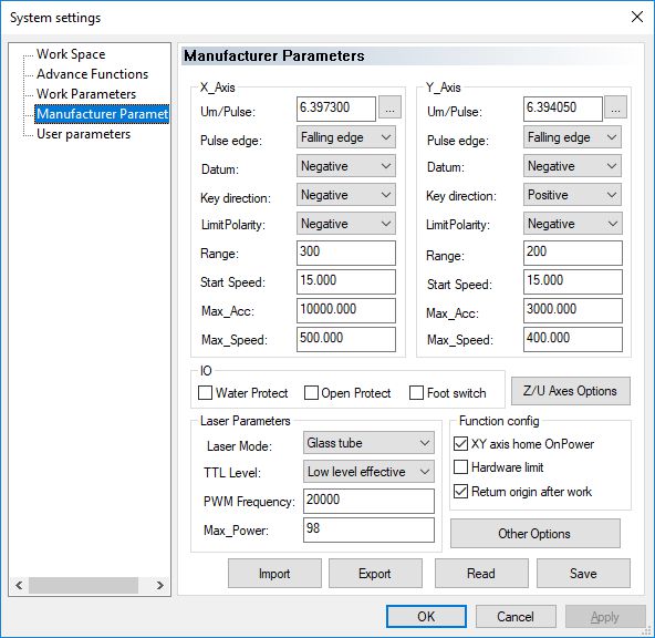

Ignore the user parameters that was from the other day. I uploaded them in stead of the manu parameters.
Re: RAYCAM V12 and LO-x7 question
Posted: Mon Sep 18, 2017 3:51 pm
by Mcaughey
manu paramters
Posted: Mon Sep 18, 2017 3:53 pm
by Mcaughey
I'm doing something wrong but cannot figure it out.
