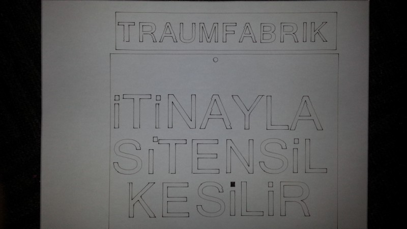

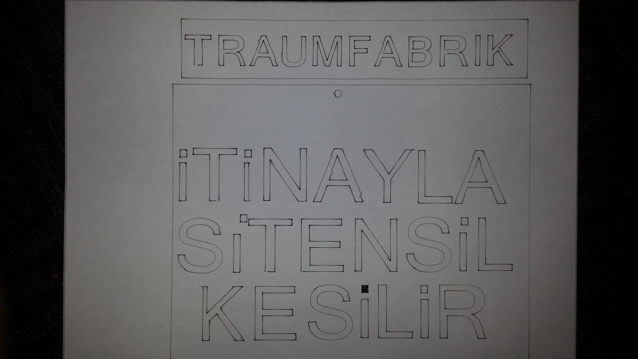

IT'S ALIVE! !!! IT'S ALIVE! !!!!!
many thanks to all that helped out with this already.
There's much more to learn, yet it's amazing to see some real results.
I attempted to cut out some text. please check out the image. This way I can see all the spacing errors between characters. perhaps I need shielding around some cables, or?
