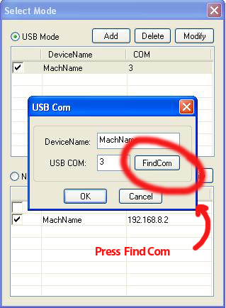

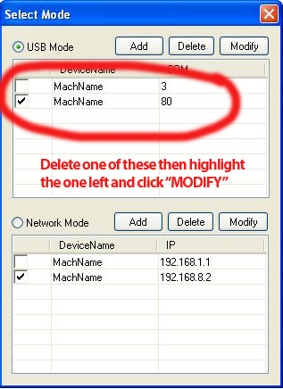

Sorry to put you on a bum steer, Walt. There is No search button!
Here are some screen grabs of what I have done to get mine working.
If the USB ports don't show up on your computer then turn the computer off and UNPLUG the power cord for a few seconds. This will reset the USB ports on your computer. You must unplug the power cord or it won't make any difference.
This is only if your USB ports are playing up.
Don't forget to save your settings under the "File" menu. Select export and "Laser" or something you understand to be the start up file for the Laser.
Here are the pics.
