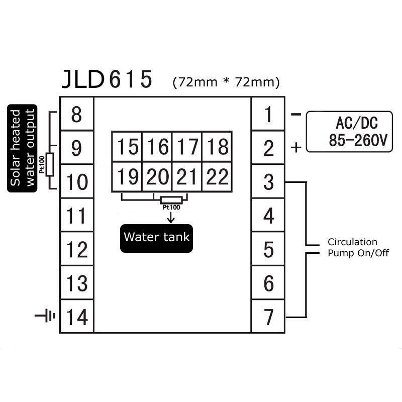

I am drawing the wiring diagram for our application, can you send a draft of the terminal strip?
Re: JLD615 Manual Needed
Working on it. See the back connection terminals below
