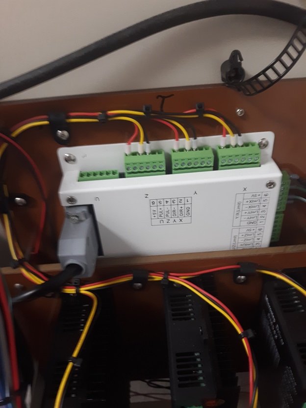

How about running a cut or framing, does anything move? Are DIR and PUL connected correctly? Could you show some pictures?

I am able to vector and raster and it returns to home, I have adjusted the um and the size is correct, I will double check the wiring for the DIR and PUL and send pictures in the morning

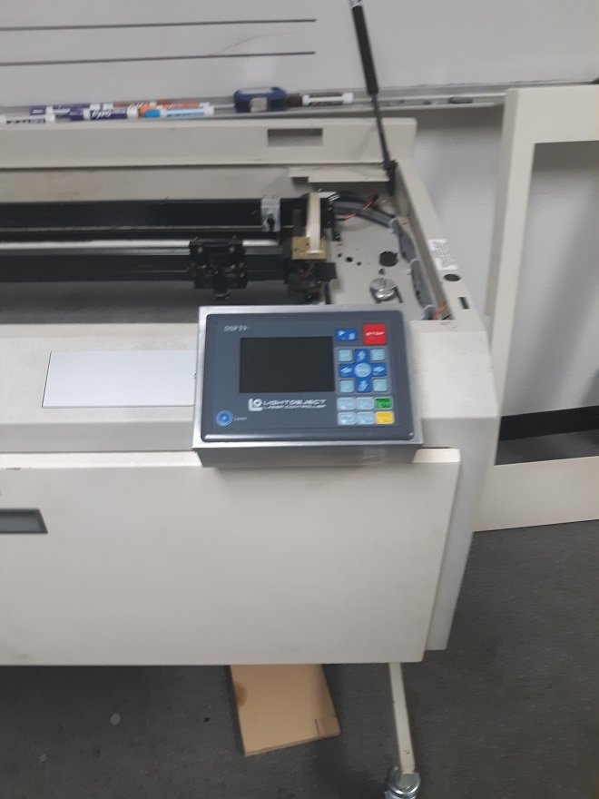

Here are the pictures, let me know if you need other pictures, I am thinking about adding the mechanical Micro switches to see if that is the issue

Okay I replaced the Omron's with Micro Switches, now the X and Y and Z will move with the jog buttons
