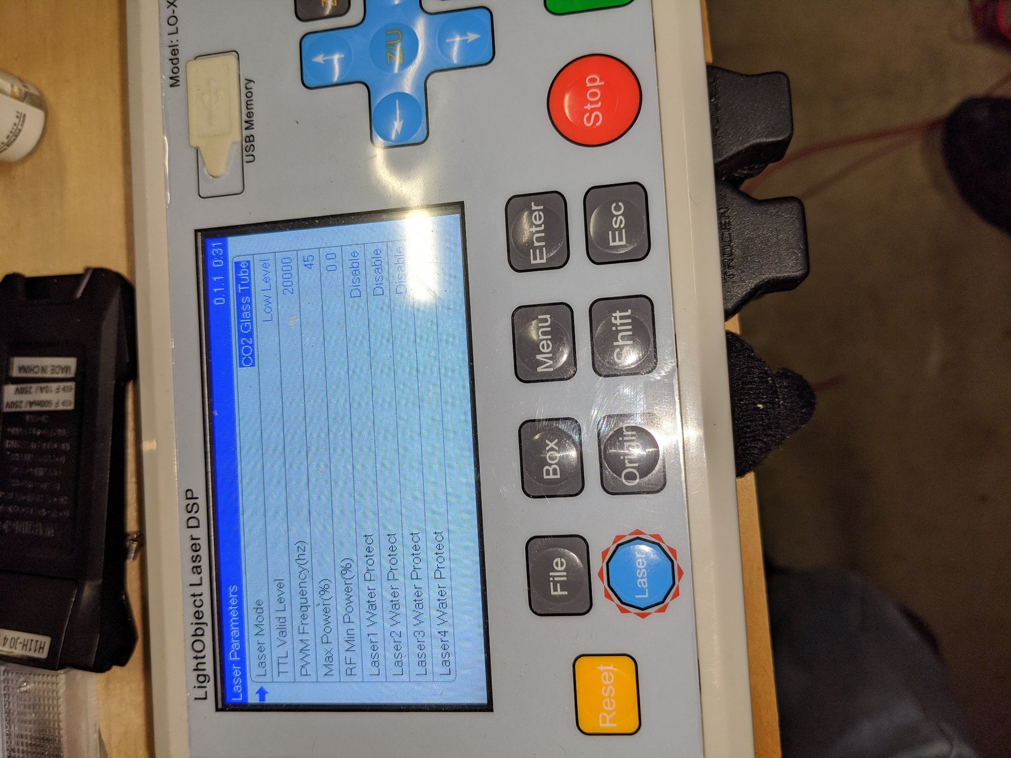

I was using a cohesion 3d before. Still using the same power supply, an hy-dy20. Is it possible there is a setting I've missed? I've gone through the laser menu in the manufacturers settings, it's set to co2 glass tube, ttl valid is low level and the pwm frequency is 20000. That should be everything, right?

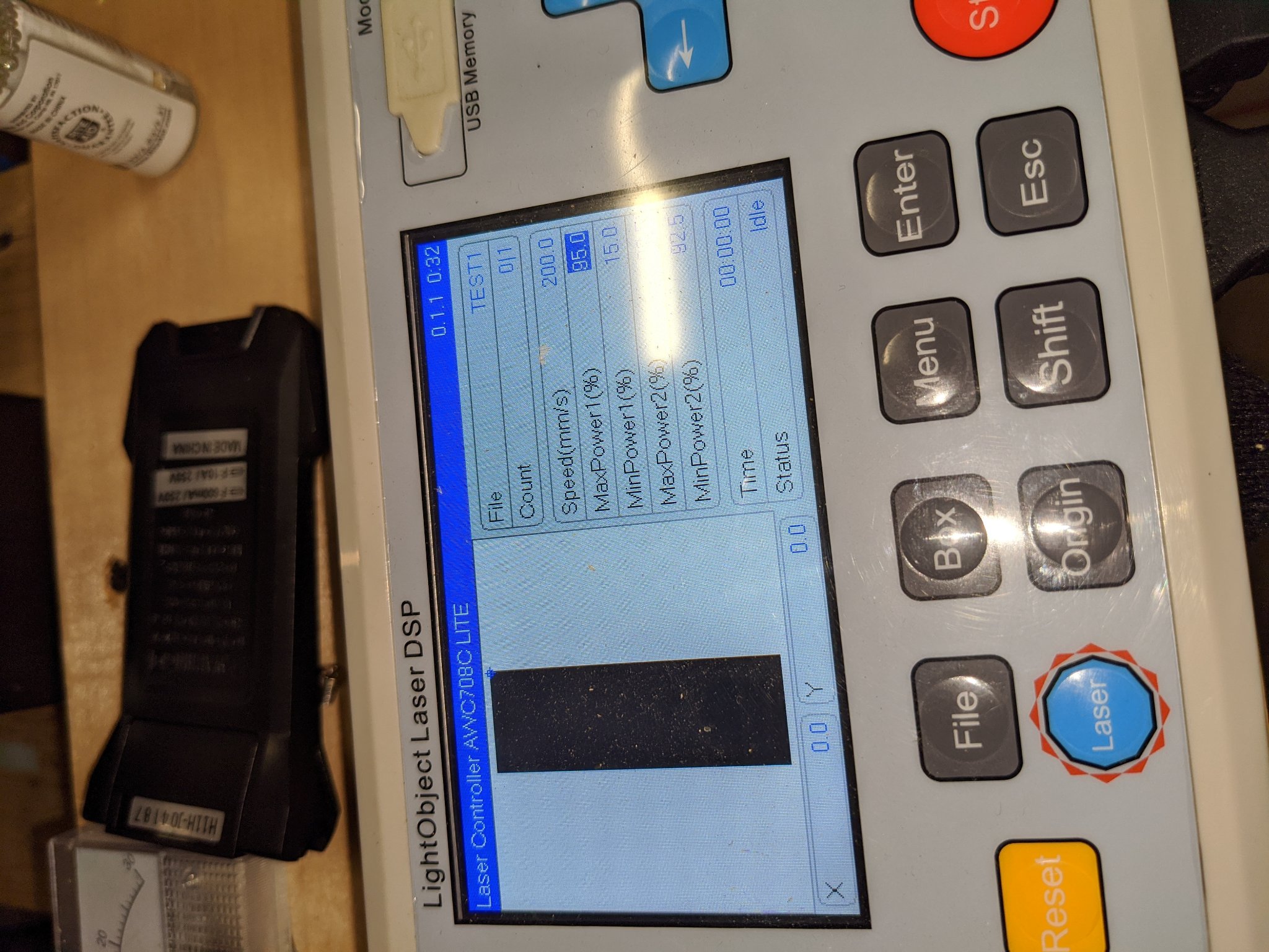

Ugh. Ok, scratch all that. The batteries in both of my DMMs were apparently close to dying. Calibrated all the meters and now, I think I understand what's happening. So I set the max power to 45 percent in the manufacturers settings as shown, expecting that that would be the max power for the laser. It appears that the settings on the front page pictured below, override that. So if I set the cut settings on the main page to 95 percent, it is not 95 percent of the 45 percent I set laser max power to, it is 95 percent power. It also appears that the pwm stays high after the laser button is released, is that correct? Also the laser button responds to the settings programmed in to the lasermaxpower1 setting, and I would have expected it to respond to the max power % in the laser parameters of the manufacturer settings.

So I hooked everything back up, and reduced the power setting on the front panel and it reduced the power of the laser appropriately. Is there any way I can make the max power setting in the laser parameters take precedence over the front page settings? I would like for the max power setting in the laser parameters to be the absolute max power and the lasermaxpower1 to be a percentage of the max set in laser parameters.
