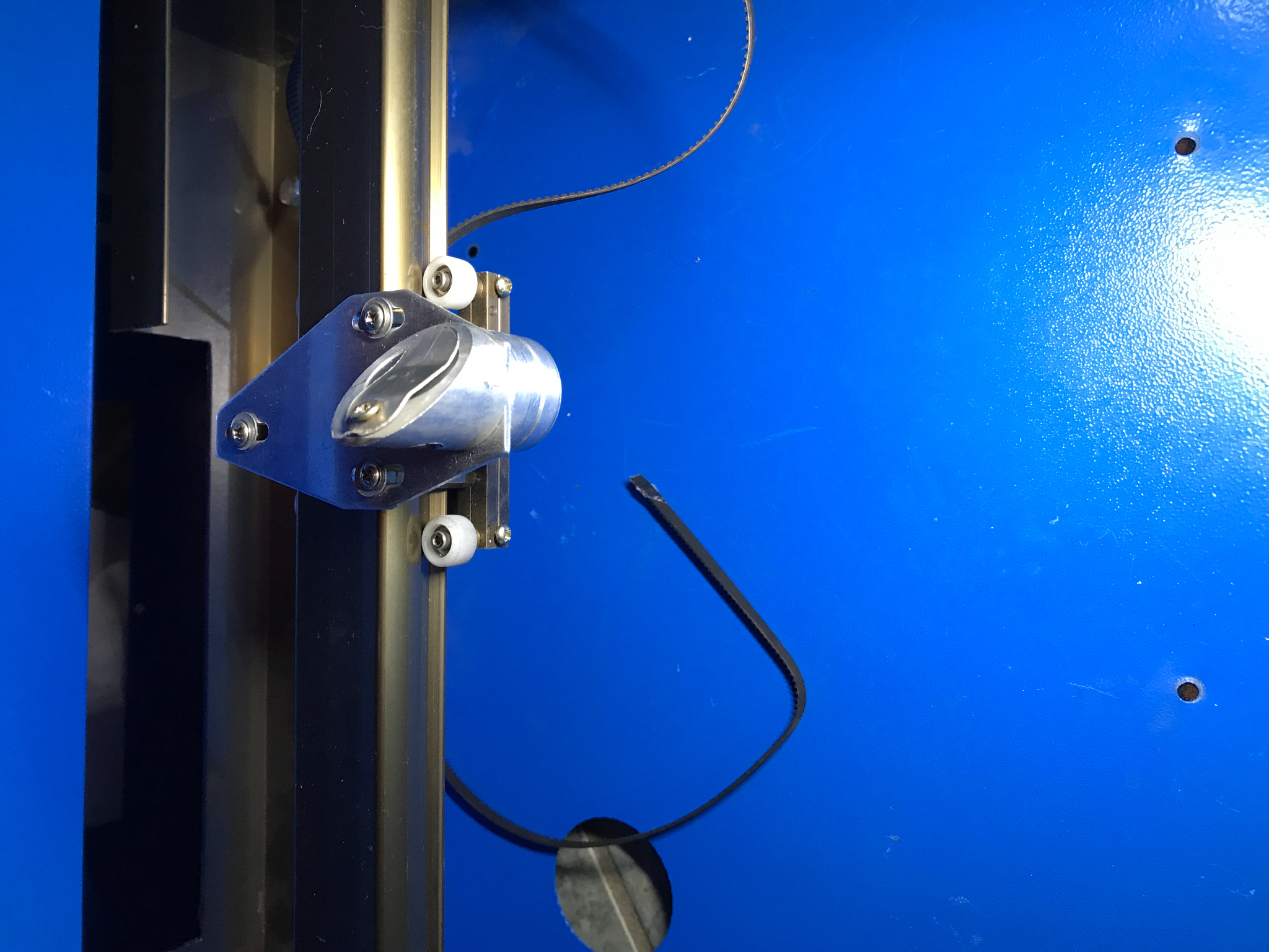

So I worked on this when I got home...LaserCad would not communicate with the device but RayCam would.
I set the parameters and the directions are now proper.
However the limit switches still do not stop the gantry...I check continuity and they are working as a N.O. switch should...when the head is in the upper left both X and Y switches are closed.
I hit reset and it promptly moved to the upper left corner and kept hammering away at it and before I could hit STOP it had pulled my X belt in half.
I'm beyond frustrated. Now I have to purchase more stuff and take the gantry back out completely to repair the belt. Is there a trick to making it recognize the limit switches?
Ross

BTW this belt: isn't it just come loose from the fixing/tensioner... Tearing a belt in two with those tiny K40 steppers?? It must have been a very bad belt.. (for the record: i use tuned 3nM motors and i don't worry that they even could tear my belt.. Belts can lift at least (a few) hundred kilo's )

Thanks Kees...I realized I needed to walk away and take a few days to come back with a fresh approach and renewed patience.
Once I pulled the gantry out I saw how the belt is clamped up underneath the X carriage piece...it had pulled out from one side. The little oval washer they used to clamp it down seemed overtightened and flared, so I inverted it so the outer edges clamped down instead and then re-tensioned it.
I grabbed a few NO pushbuttons and wired them up with it slow and it worked setting the limits...I've redone the wiring and with the gantry outside the chassis the limit switches are working.
