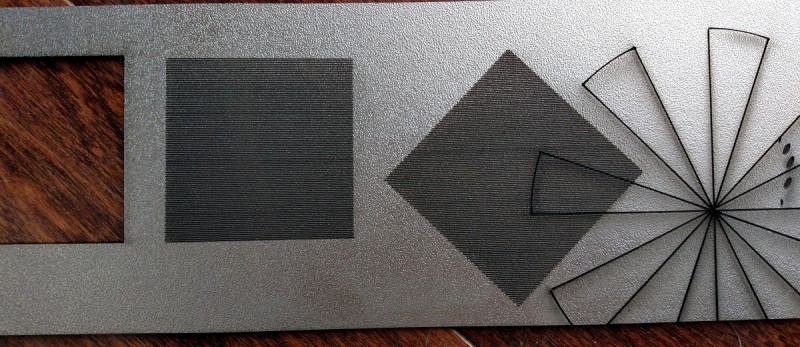

I ran this test file Marco put on the forum and to me it shows the machine is in great alignment and no belts have slack in them. This was cut at 100mm second.

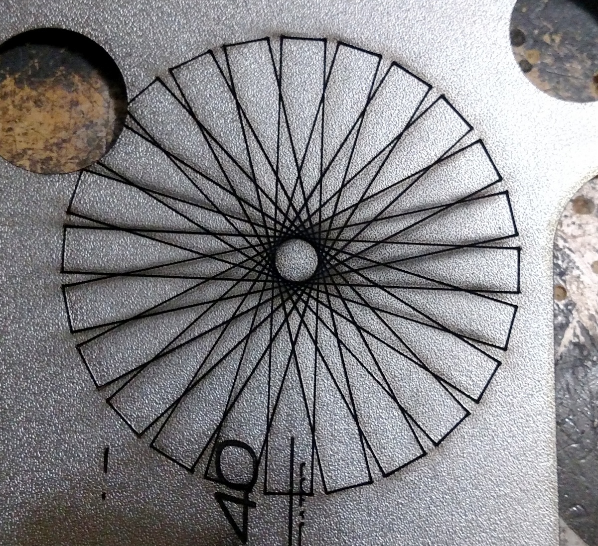

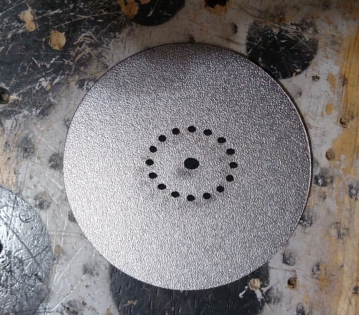

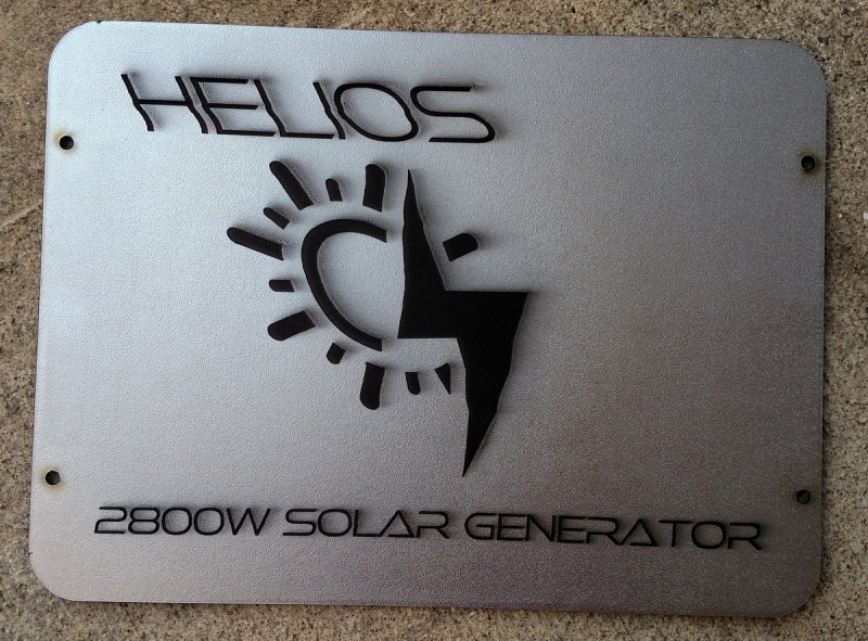

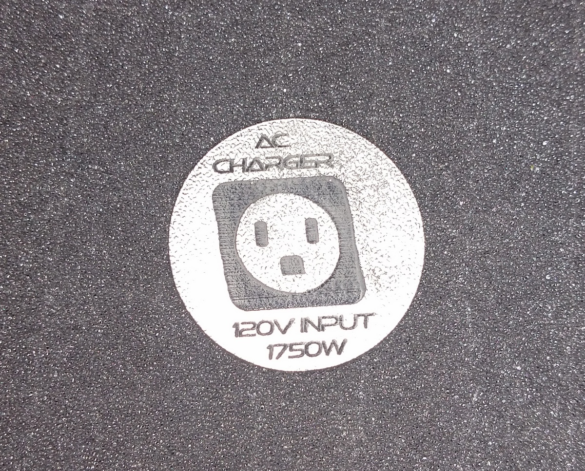

Here is another file I cut that shows the engraving is skewed but below the text is almost perfect for some reason?
Here are a few more files showing how the engraving skews to the right as it moves down.

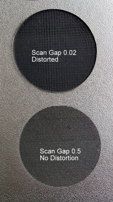

Normally on all my engraving I choose a scan gap of 0.02 I have also tried the 0.03 but the distortion remains.
Here is 2 circles created in laser cad and it looks like when using Scan Gaps of 0.5 there is no distortion, but 0.5 is not fine enough for my normal work.

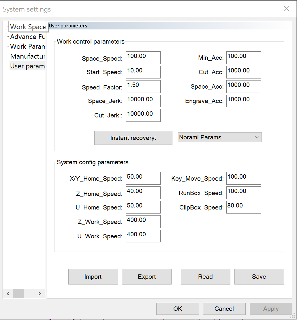

Re: Laser Engraving Distortion Problem!
I think the acceleration are too low
You need to raise 3~4 times on the x and y
Cut jerk and space jerk need to set to 10,000 and 20,000 respectively

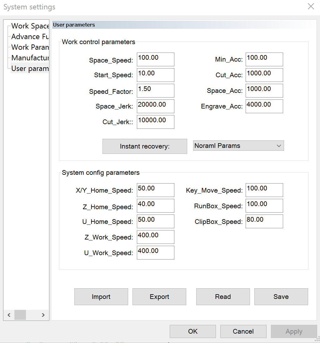

YES that fixed it!! The machine is much quicker now also.
Not sure how I ended up changing those settings but I think when I installed the new software I hit the reset the Normal settings and that's what it had as defaults.

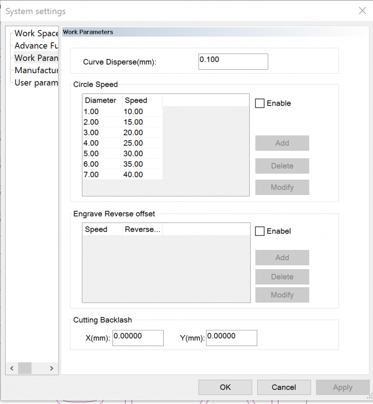

Here is what I now have. Let me know if need to change anything else please.
I will do this:
Cut acceleration: 2500
Space_Acc: 2500
Engrave acceleration: 5000~6000
Min acceleration: 200
Start speed:15
Key_move: 200
Run_box: 200
Home: 80
Clip_box: 100
If it works better, send me a cup of cappuccino and a piece of cheesecake!
(@LV)
Space_Acc: 2500
Start speed:15
Key_move: 200
Run_box: 200
Home: 80
Clip_box: 100
(@LV)

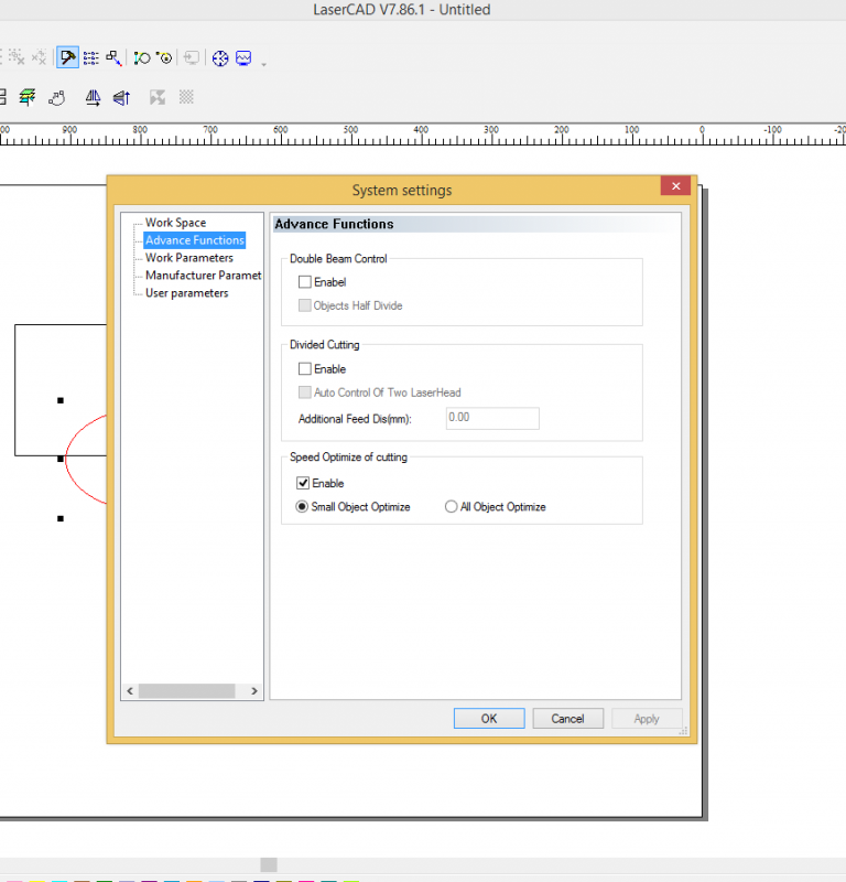

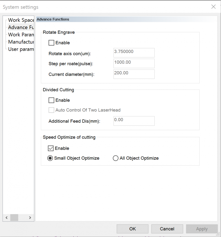

Hi Marco, I have downloaded the latest version 7.86 but I can't see the options on the Settings Tab, Advanced Options. Please check the attached screenshots there is no Rotate Engrave options. Could you tell me what I'm doing wrong, or if I need to download a new versionTech_Marco wrote:Try the latest one I posted
viewtopic.php?f=55&t=3330
I think there is an issue with the 7.9
Give it a try
