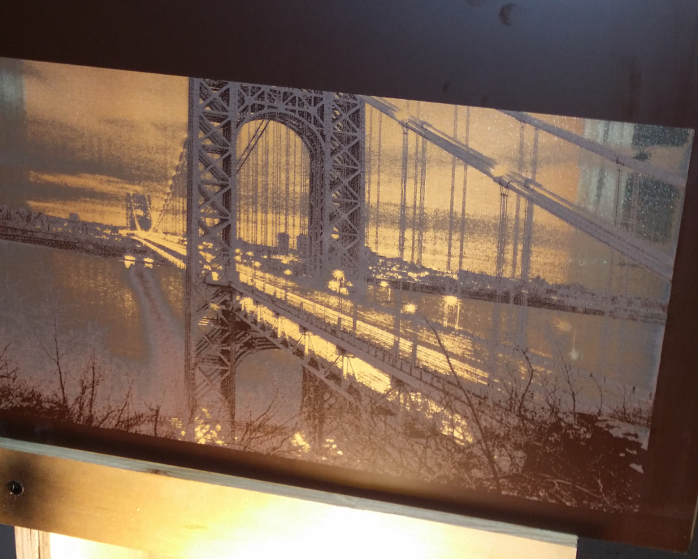

I updated the DSP with the new file. A few of the files that did not previously work now work however the majority of them still do not work. I attached some work I did prior to getting the DSP. I did the files attached with Mach3 and the engraving plugin. Here are some steps I have taken and what has resulted.
1. I have imported a vector file and ran engrave. It works fine for the first 30 lines then becomes completely distorted however it shows that it is fine on the LCD screen. I have tried to import this same file from many other softwares as DXF, AI, Jpeg, BMP all gets the same result. I have even traced the lines within laser cad and still get the same issue. The first 10% of the file comes out great then it progressively starts skipping more and more lines.
2. I import a bmp and just run the engrave and it works as expected. The image comes out in black and white. I take that same file in lasercad and use the tools to dither the image. I run that on the DSP and now it has very large line gaps and the image is stretched out.
3. This issue still only appears to happen with imported image files. I can create a graphic and engrave fine from within lasercad. While I think the update did fix a few issues that I had I am still having the same problem. I will read over the forum again maybe I am missing something in the software.
This is perplexing just because it works fine with everything other than imported images. I also noticed that I do have better results on very high resolution files. I will post some images of what is happening as soon as I can.
Thanks for the quick response on the update!

Here is a file that I ran before and it worked and now it is way stretched out on the Y axis.
Here is a link to the actual file https://drive.google.com/folderview?id= ... sp=sharing
Here is some more info after testing, I might be getting close to figuring out what the issue might be.
I tried to slow the speed down and here is the result.
https://drive.google.com/open?id=0B6gKe ... authuser=0

I do have the X7. It does not take very long to finish on my machine just a few minutes. I use laser cad to scale it down to about 100MM tall. Here is the example again of the 2 different speeds.
https://plus.google.com/photos/yourphot ... 5121797373
I will do more testing at the 500 Speed setting and see if the images are consistent. Thanks for all your help.

Marco here is an example of what it does
The bottom part completed at 500MM/s 10% power and a 0.05 scan gap. The top image is the same settings only changed power to 20% and it started skipping lines like crazy. Hope this helps with understanding what the issue might be. It seems to be speed / power related.
