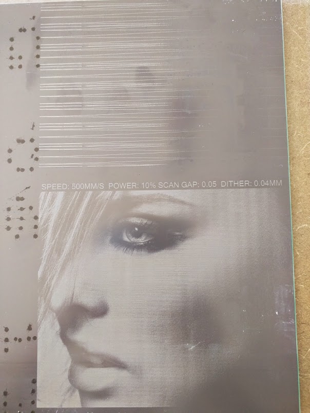

Marco here is an example of what it does
The bottom part completed at 500MM/s 10% power and a 0.05 scan gap. The top image is the same settings only changed power to 20% and it started skipping lines like crazy. Hope this helps with understanding what the issue might be. It seems to be speed / power related.
Larry
Larry

I downloaded the Ninja pictures and tested it on 500mm/s and 1000mm/s with my 60W laser and has the power setting set at 50% and 60%, it came up fine
I don't think it is DSP issue but something else. The most suspicious cause is the interference from the LPSU. Double check the grounding and avoid too closed distance between the HV cable to the signal wires
