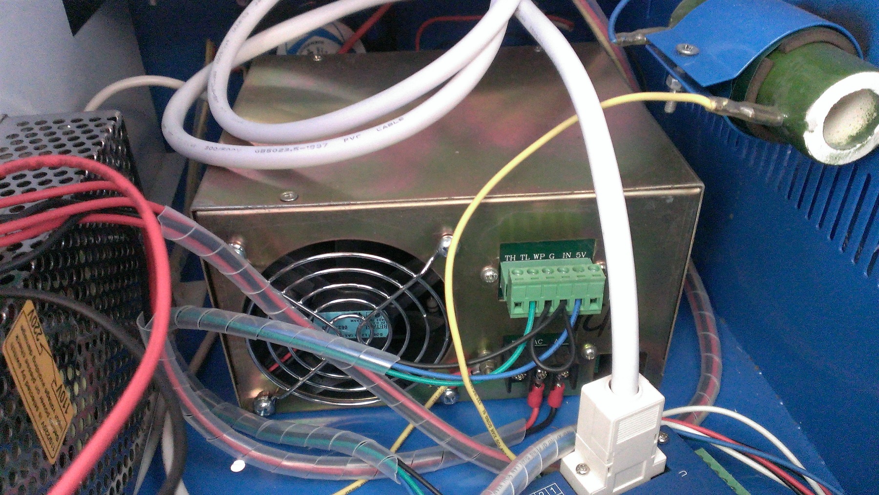

The very first thing I need help with is the power supply. The laser does work with it and it appears to be a PWM power supply however it looks different from all the ones that's been posted here. Could somebody confirm that it is good enough for the DSP?
I kept the big green resistor (I don't know why) but it will be flying out of there very soon.

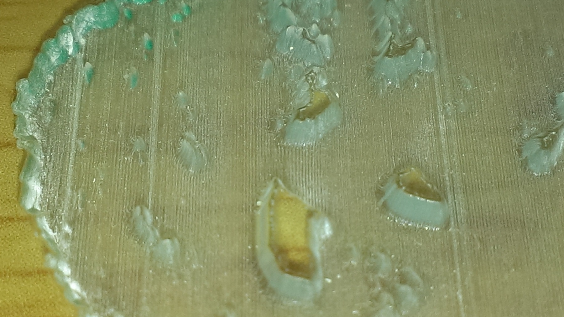

The second problem I have is that the cut edge on the acrylic is not smooth. It has irregular grooves in it. I'll post a picture of it later. I know that the laser leaves a pattern on the cut edge but what I see is not normal and appears to come from a problem with the motor that moves the head on the Y axis. It also shows up when I engrave something. It looks like after engraving a line the head is supposed to move down a step but it doesn't. Engraves on top of the previous line and then it jumps down 2 steps. This only happens on certain spots but always on the same places. Also that motor is very loud when moves and gets very hot. The controller is set to the lowest current (as far as I know).

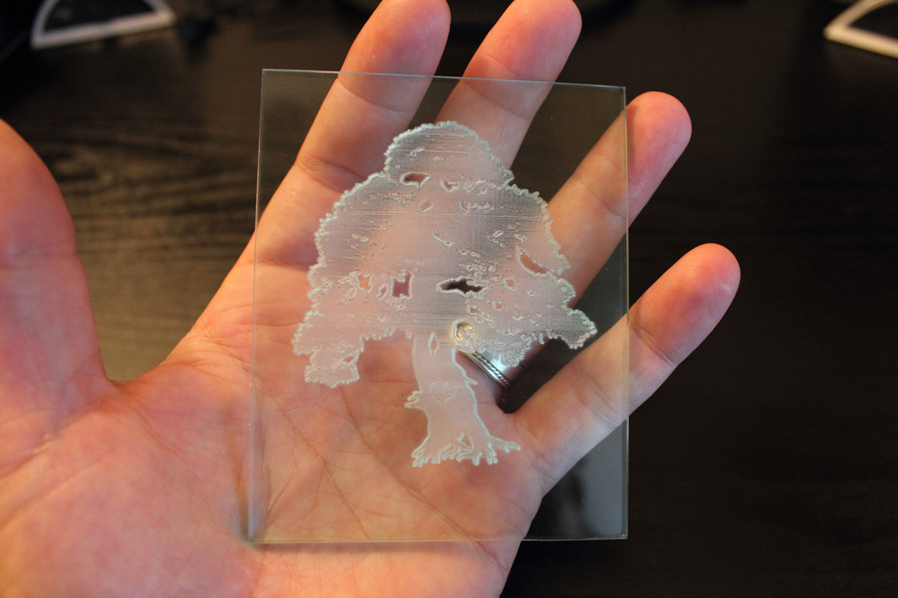

I attached a picture of a piece of acrylic I engraved. You can see the lines where it was skipping.
Re: Reviving my K40 + DSP project
To engrave acrylic, you may want to out-focus a little bit (intentionally to set focus point over a little). It may reduce the "lines" effect a bit.
How fast did you run? K40 should be run over 400mm/s as over than that the machine may suffer from vibration and escaping.

My problem is not the small lines but the bigger ones that you can see in the pictures. It's not visible here but if you look at it with bare eyes you see that they are higher than the rest of the engraved surface. It makes me think that the motor skipped a step.
Also could you look at my power supply? Is that good for the DSP? I didn't see anybody posting one like that.

The lines are horizontal BTW. I just turned it this way so they are more visible for the camera.

Why don't you do the job on a piece of better acrylic?? I have hard time to see the image and not sure what exactly you mean.
The power supply looks good to me. You just need to limit the current not over 18mA to your K40 machine
By the way, make sure you have good grounding connection on your machine. Otherwise, interference from static may cause escaping

Please, read my first post. I haven't used my laser for 2 years now. This piece was made back then. Right now I can't even use it because I can't find the software for it. I'm trying to finish it and make it usable.
I'll take better pictures when I get home so you can see what I mean.

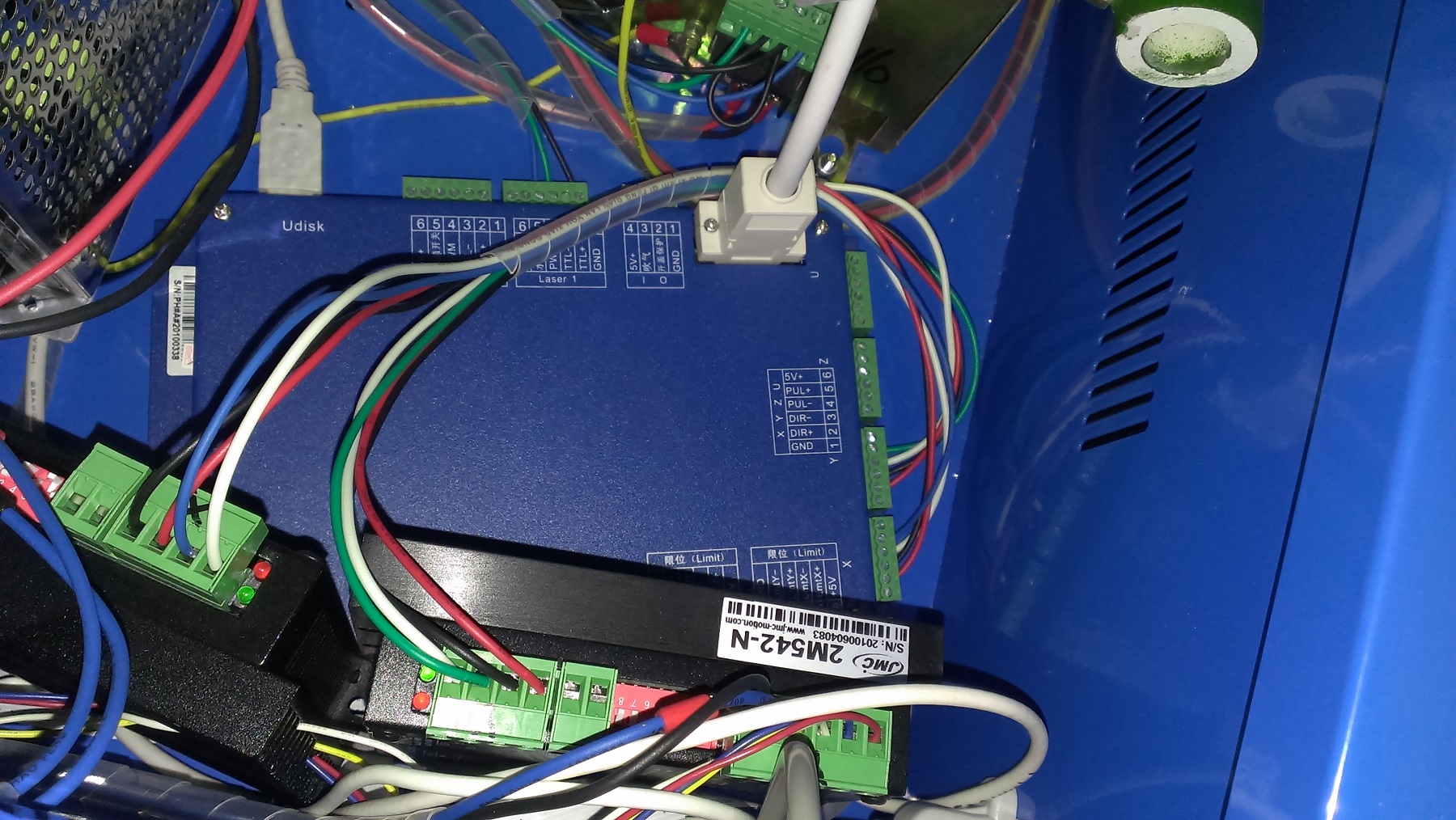

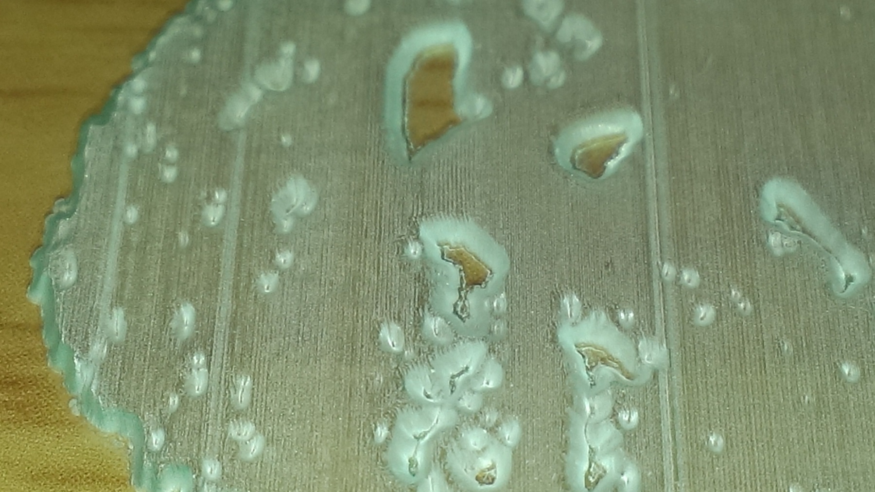

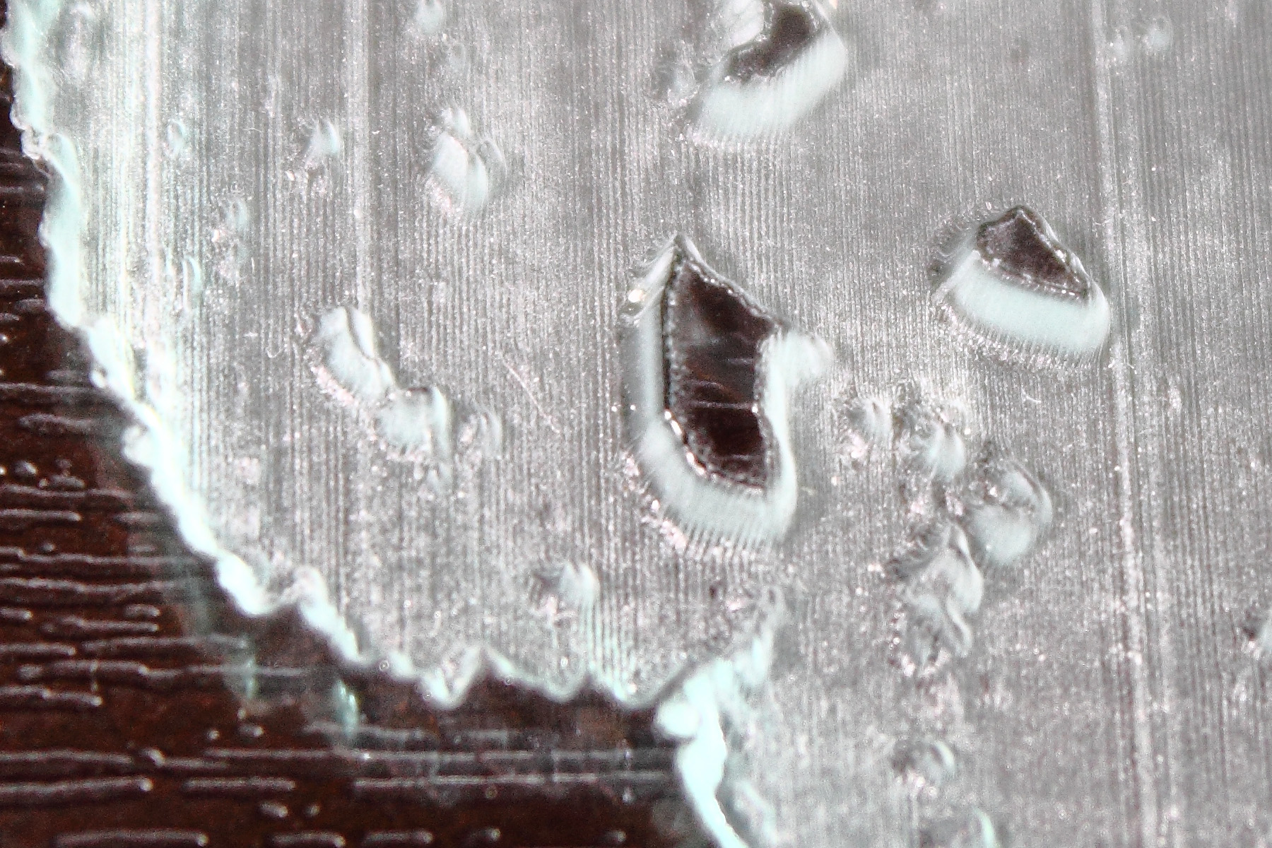

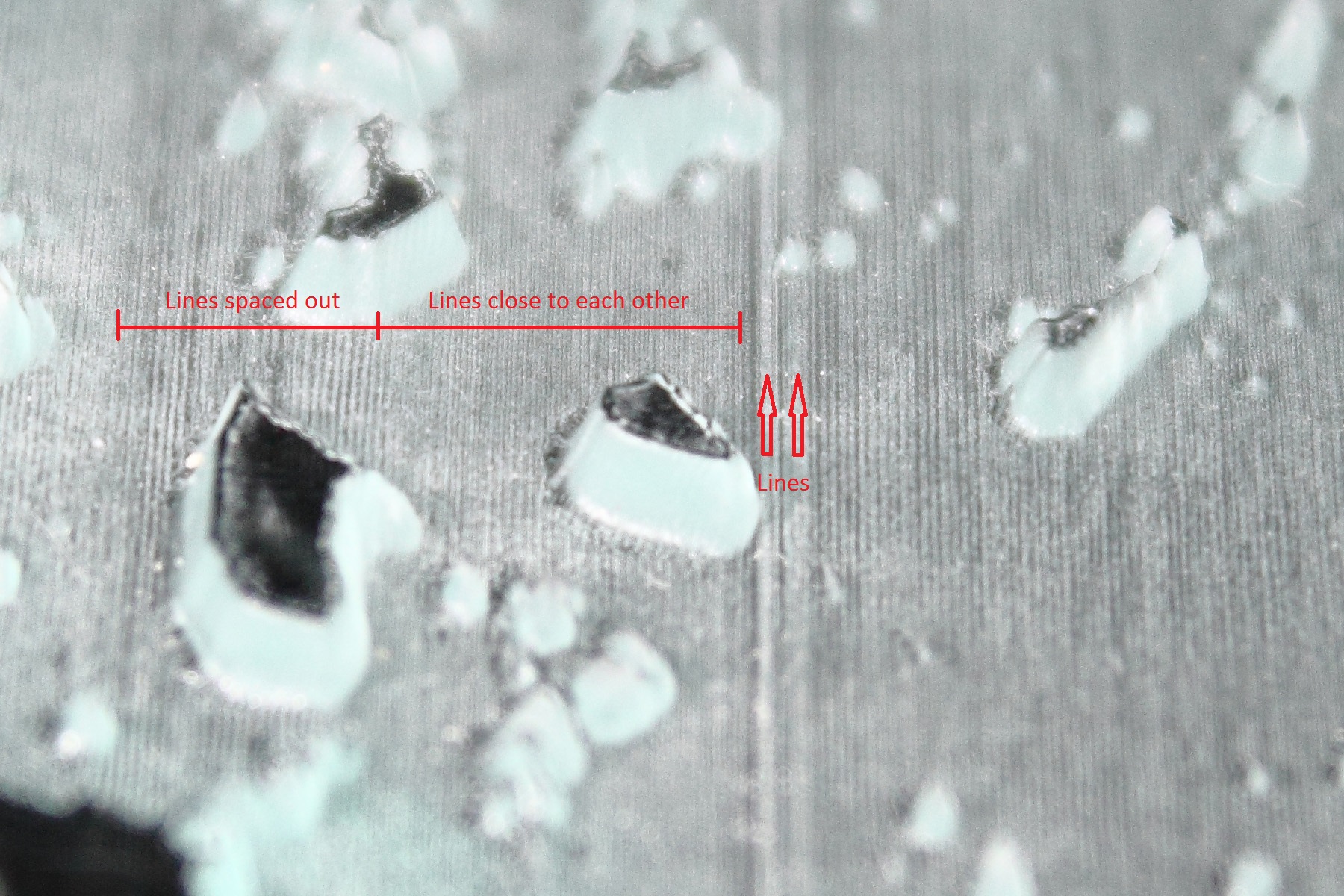

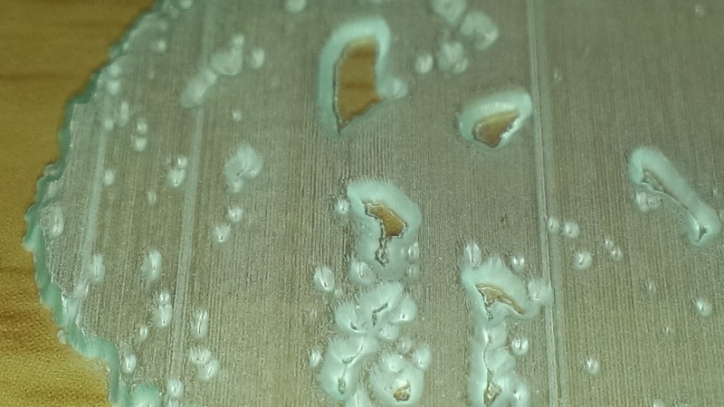

I managed to take some pictures. I hope they will help. When I looked at it closer I also noticed that the grooves the laser left behind are not spaced out evenly. There are sections where they are closer to each other and where they are further apart.
Just PM you the last PHCad I have. The card is no longer support and no hardware patch.
One thing I saw wasn't right is that you're using 2M542 motor driver which output current is much higher than the motor can support
The K40 need 0.4A on X and 0.9A on Y. Micro-stepping should be set to 1/8 or 1/16.
You may change the "Falling Edge" or "Rising Edge" on the setup as it may fix the issue. There is not much I can support as I no longer carry the board.
