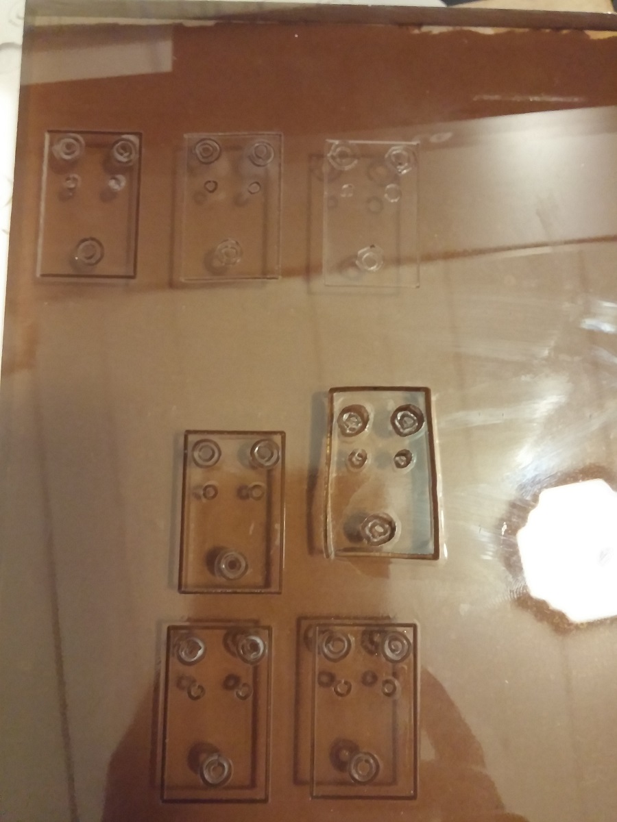

I attached a picture of some more tests. The particularly grotesque cut was done at a speed of 1mm/s; slightly less deep ones are 5 mm/s, then 15 mm/s then 45 mm/s.
