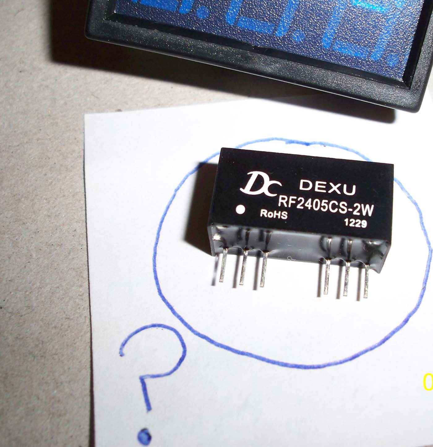

What part is this and how is it connected?

Received this along with my digital meter (I think they go together, came in same package) and I can not find any info on it. What is it and how is it connected? Thanks.

This is a 24V to 5V power module for getting the 5V the meter needs from the 24V DSP power supply. The pins are described on the products page http://www.lightobject.com/2405S-DC-DC- ... m-P84.aspx. You can see it hooked up in Marco's pictures here: viewtopic.php?f=70&t=1528 (3rd picture down, backside of the control panel).
Re: What part is this and how is it connected?
Or from this post (more exact)
viewtopic.php?f=14&t=187
